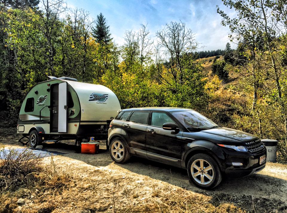

Hello! New owner of a '15 171 R-Pod here. Been looking for awhile for the perfect trailer that would tow behind my crossover SUV. Needed something light, but wanted all the conveniences of a bigger trailer, so ended up with the R-Pod (which I had my eye on anyways). Love it so far. Have some electrical issues the dealer needs to address (drained the car battery when I took it out the first time). Otherwise, had a great time on it's maiden camping voyage...
Cheers and happy camping!
