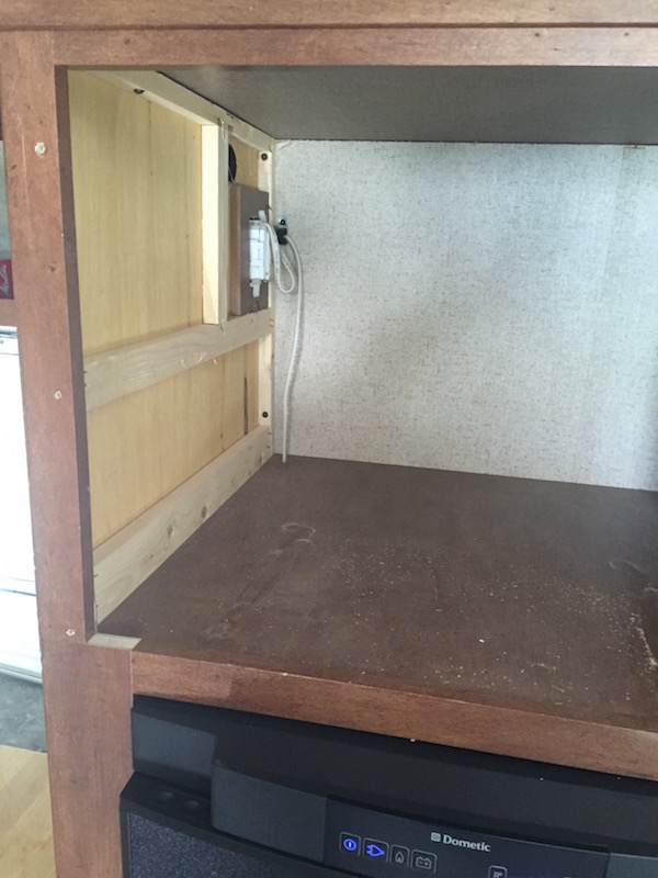

I'll be installing a magnetic knife holder in our 178 tomorrow, actually. My plan is to screw it into the wall on the left side of the fridge/ MW. There must be a 1x nailer (I haven't looked yet) that holds up the shelf supporting the MW. I'm worried that the wall by itself will not secure the holder given the constant pull of the knives against the magnet. I'll let you know what I find.

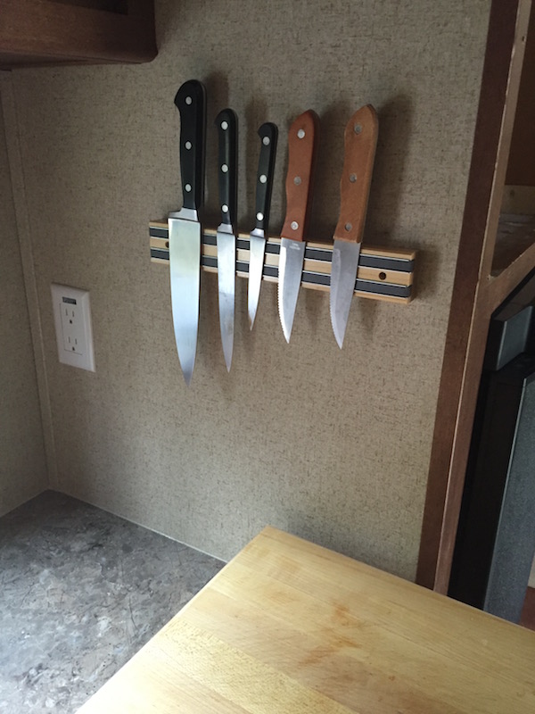

Direct Link To This Post Posted: 16 Jul 2015 at 4:35pm
Just installed knife holder, screwed into 1x that holds up MW:

Direct Link To This Post Posted: 16 Jul 2015 at 6:51pm
Excellent!  thanks much for the pictures!  Thumbs Up
I'll verify mine isn't any different from yours (another shipyard thing -- not all ships of a class are built the same way) and quite probably screw into the same stringer for our knife holder!
