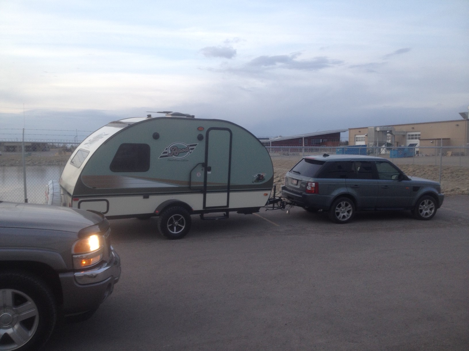

Direct Link To This Post Posted: 29 Apr 2015 at 4:46pm
Just picked up our 176!! We are so excited!! I am noticing a modulation flicker of the brake light on our trailer even when our lights are not on they flicker. Anyone got any ideas?
