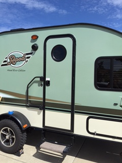

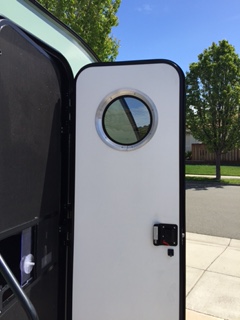

I installed a 12" round window in my 178 trailer today! The project went great and I love being able to look out the trailer door before opening it!!!!

Looks great! How long did it take you? Was it overly challenging?

Prep time took a while, also i took some time to look at the cut before I started! the cuttung went great (just foam and overlay). I cant belive how different it looks inside. I really enjoy being able to look out while standing inside the trailer.
Dave
Direct Link To This Post Posted: 11 Apr 2015 at 7:48pm
Of all our mods, I think it's my favorite. Looks like you did a good job. :)

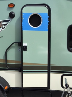

We just placed the order for the window off Amazon, thanks for the tip, Dave! I showed my husband the pictures of your new window and told him it better look that good when he installs ours, or else Big smile When you cut the hole for the window, did you make the cut from the back side of the door? I assume you just used a jigsaw, right?

I debated removing the door from the trailer, but removing 18+ screws was too much! I made the cut from the outside (remember to open the door so that you don't cut the screen door). Should only take a few minutes to cut the door. It took a lot longer to post the photos :) good luck, let me know if you have any questions....

Yes, I used a jigsaw for the cut
