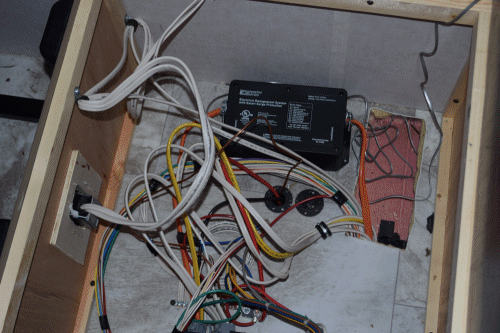

These do come with instructions. The existing romex (orange) in our
180 had just enough slack to do the job. The only downside is I will
have to disconnect them from the box if I ever want to pull the
converter out the front. As for the ground wires it is easier to just
first add ground wires to the box THEN twist the romex grounds to them
after the box is down in that cramped space. I ended up placing the
monitor INSIDE the cabinet above. I had it mounted up next to the slide
switch at first but was starting to get a seizure watching it constantly
cycle.
