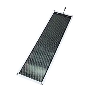

I just took the plunge and bought a Powerfilm 13 watt rollable solar panel for trickle charging the two marine batteries either at home or while dry camping. I haven't received it yet, but I will report back on how well it works with charging a (disconnected from shore power) pod. I'm busy with grad school right now, but I plan on posting some pictures and a write-up about my observations in regard to how well solar power works to maintain the batteries. Unfortunately I will not be able to charge a Macbook pro on this panel (because the power fluctuates with the weather and the Mac needs consistent power to charge), but I can charge my cell phone, ipods, and ipad with it. I can also trickle charge the truck battery through the cig lighter plug. This thing is cooler than bees knees.

is this the item you mean.?
it looks pretty usable! I wonder if it could mount on the roof of the pod, either permanently of just while you are dry camping somewhere.

Yes, that is the one. It is completely water proof, so you could permanently mount it to the sloped rpod roof, although, for me, I am going to drape it over the roof and hold it down with some bungies to secure it. I plan on using it mainly for when I dry camp to see if it can maintain the batteries in between hookups. I don't think the power output will charge the batteries quickly, but it may buy me a day or two before having to charge the batteries with the generator. I also plan on taking it with me if I do any backwoods hiking so that I can keep the ipod and ipad charged. Well, I don't actually have the ipad yet, but I'm looking for a good deal as well as the ability to load my own books, music and apps on it. Right now, you can only download what you need via the internet. I suppose I could figure out how to do that via email to myself or something.
Anyway, the Powerfilm is one of the few I've found that has everything I want and need. I wanted something portable, something I could leave outside in any weather, and something that uses a 12 volt female connection as it's power hookup while also generating .90 amps and up to 15.4 volts. It was also one of the better rated rollable solar panels and it was on sale at Amazon. I couldn't afford a 28 watt unit, so I had to settle somewhere in the middle.

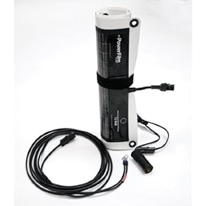

Ok, I have another question: We just have 2 deep-cycle marine batteries that sit in plastic housing just behind the propane tank. Will we need the daisy-chain wiring so both batteries use the trickle charger? Also, along the same lines, would you recommend the charge controller?
We are looking at the Powerfilm 13watt charger as well, but the recommended items are the RA-6 daisy chain and the RA-9 charge controller.

The Daisy chain cord is only for connecting two or more solar panels to each other, so you won't need that. The panel comes with an extension cord with eyelets to hook to the battery directly, but you want to hook the controller up to the solar panel first. Amazon carries all of these cords and such too.

Your dual batteries are wired in parallel, otherwise they would be putting out 24VDC!. The simplest connection is clip the positive 'charger' feed to the 'red (+)' post on one battery and the negative feed to the 'black (-)' post on the OTHER battery. Your Pod OEM charger is set up the same way if you have dual batteries. Most experts suggest that the batteries have the same capacity (type 24 is the usual size in our Pods), and they also suggest that the batteries should be the same brand.
