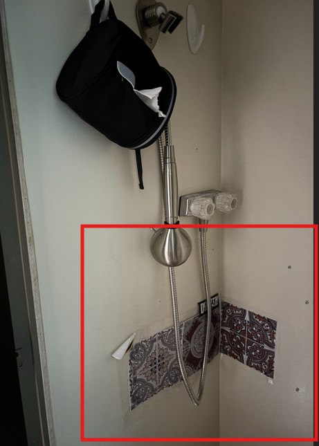

2018 Rpod RP-171 new to me. :) The previous owner seems to have cut the wetbath liner (I presume to access water lines or similar). I'd really like to replace it but I can't seem to find an online parts dealer or catalogue. I'm reasonably handy and think I could complete the job - just need to buy the parts. Any ideas? Many thanks!

Thank you - it's two of the "walls" that make up the wetbath liner. I'd like to replaces them both. Here is a picture enclosed.

I believe what you are seeing in this bathroom is where the sink was removed, leaving the two spots shown in your picture. When I removed the sink, I bought a single 4x8 sheet of embossed white fiberglass reinforced plastic that I cut to fit the area below the faucets and then wrapped it on the back wall at the same height. I removed the two pieces of corner molding, secured the panels with liquid nails, then retrimmed the top of the panels and the corners with matching trim that I purchased in the same area of the big box store. It's lasted 10 years so far. Cutting the sheet it the most difficult part of the job. I got my stuff at Lowe's, but I've seen the same products at other home improvement stores.
