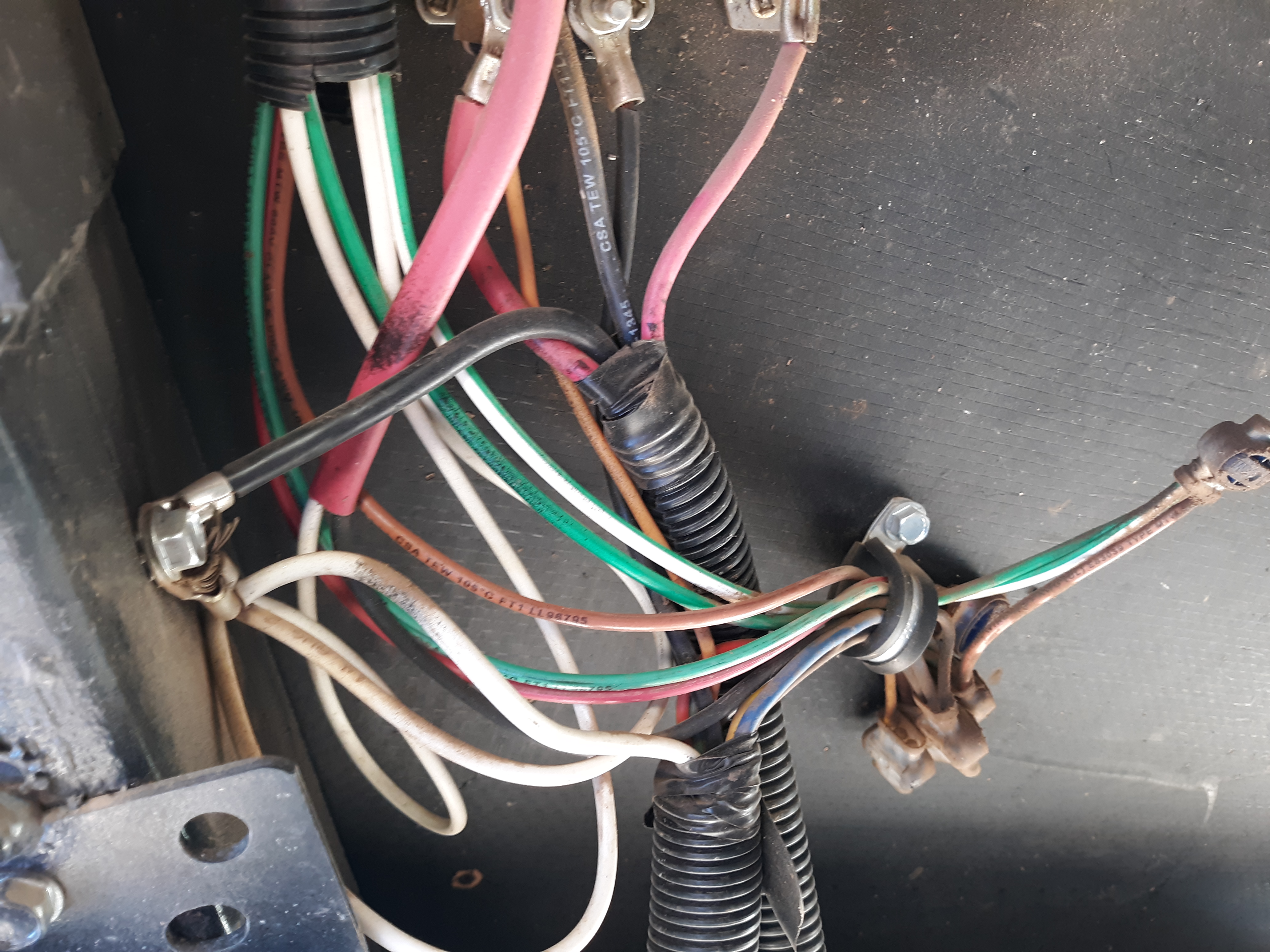

Post Options Post Options   Quote Gregs Pod Quote  Post ReplyReply Direct Link To This Post Posted: 10 Apr 2022 at 11:36pm
Thanks
yes two bats are in parralell.  two batteries with two positive and two negative wires from batteries to harness under the trailer. to controller from batts is the question looks like just one positive and one negative from underneath and controller reads only one battery. tech said thats ok but controller instructions say two batts should have two sets of wires. I should jus open it and look. two panels with four wires into two on roof then into controller.

Post Options Post Options   Quote Gregs Pod Quote  Post ReplyReply Direct Link To This Post Posted: 10 Apr 2022 at 11:41pm
crikies thats huge lol

Your tech is right, you should just be using battery A terminals. The B terminals are for charging an independent battery bank, say if you wanted to charge your vehicle start battery separately. You aren't doing that so your two batteries should be connected in parallel (they are) and then connected to the battery A terminals.
I did notice one thing when I looked at your charge controller manual. It states that you should not connect the solar negative terminal to chassis ground. Both wires from your solar modules should be connected directly to the controller and only to the controller. Perhaps this is because the controller is switching the negative side of the solar array to regulate the charge voltage. In any case check to be sure that it's wired as specified. Also check the battery type that is selected on the controller matches what you actually have on the trailer.

yah resizing photos I'll try to sort that out. Too busy playing electrician to be an internet wiz;)
Thanks so much for digging deep into the manual. I saw that about the ground too and it looks in that massive picture like it is ground to the chassis. That would certainly explain it working momentarily and then shorting. I'll let you know how it sorts out. Be talking to the dealer that installed the controller and panels today.
