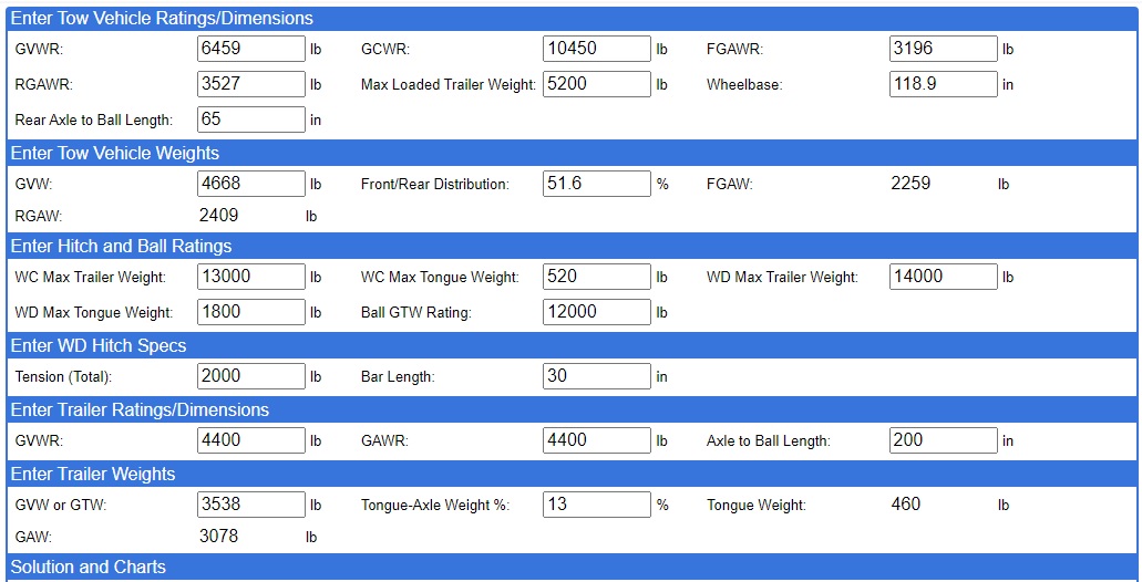

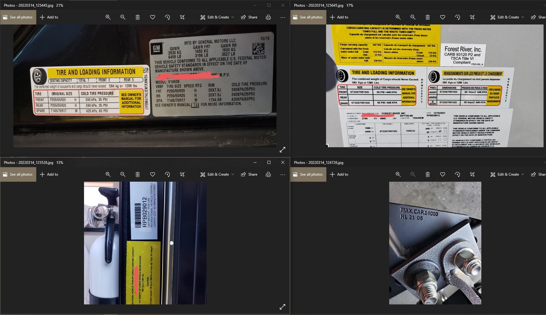

Posted: 14 Mar 2022 at 12:16pm |
Started to fill out what I knew online in the calculator. Not 100% sure I have all the numbers correct. Anyone see anything I missed?
