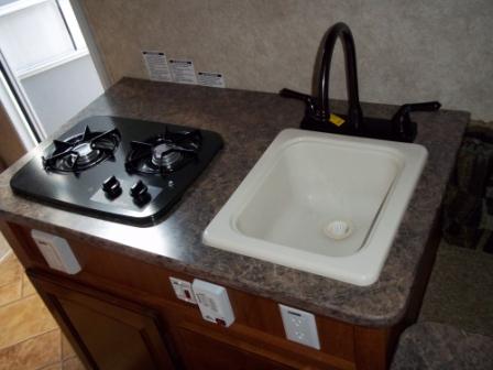

Anyway, I try hard to keep up with cosmetic wear and tear on my 2016. I'm having a problem with my counter top and I'm wondering if anyone else has had this. The marble look covering is peeling up from the hard surface in a couple of places on the edges (on the corners where it gets bumped). I am not up to replace it altogether but I'm wondering if there's a more basic fix to keep it form getting worse. My dad would have run a 1" piece of duct tape all around the edge and that would have solved the problem at least for a while. I don't want to do that...exactly. Anyone else have any thoughts?

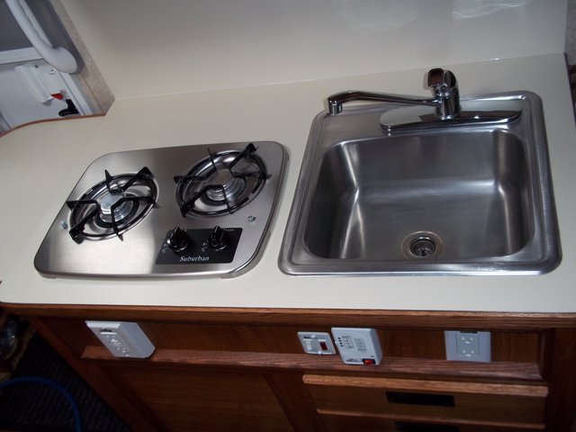

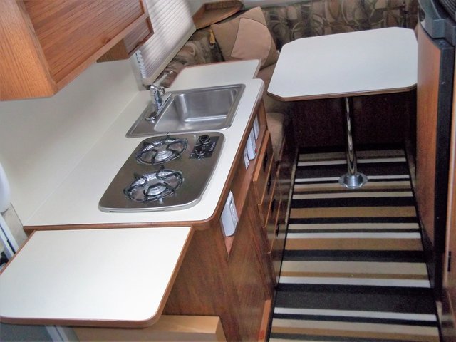

If it was mine i replace the counter top with 3/4" plywood and flat work laminate with solid oak edging.
