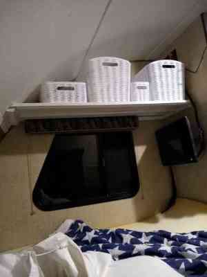

Pod People ![]() Senior Member ![]() Joined: 22 Sep 2011 Location: Chapel Hill,NC Online Status: Offline Posts: 1090 |

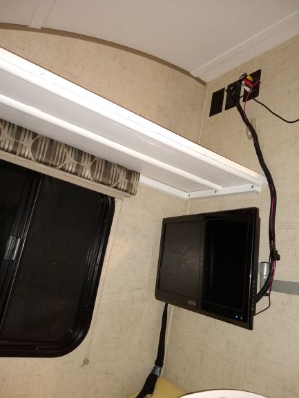

Many thanks to Vann for his inspiration!! I was able to nearly duplicate his method of creating a shelf at the foot of the bed. For the shelf I used left over wainscoting plywood, corner trim molding and for support directly under the shelf a split closet rod. I fashioned for wall supports using some wood I had and attached at the endwall using screws and construction adhesive. I attached the side wall supports to the wall where the aluminum frame is located next to the window and wardrobe. In addition to this I moved the TV (another inspiration from Vann) down since it really is at a odd height to be enjoyable also it was in the way of the shelf. I added support inside the wardrobe to carry the load of the TV and the shelf support. A bit of calk and touchup paint should complete it. A great space saver mod!

StephenH ![]() podders Helping podders - pHp ![]() ![]() Joined: 29 Nov 2015 Location: Wake Forest, NC Online Status: Offline Posts: 6463 |
For us, that shelf would be at the head of the bed. We switched around because it helps with sound isolation from the AC and water pump since the pump is underneath the other end. Also it helps block light when I get up and turn on a light in the morning. I put up a curtain across the opening for light control also. My wife likes to sleep in and this keeps her happier. I ran my shelf across. We really don't watch a lot of television. When we do, we are usually sitting at the dinette.

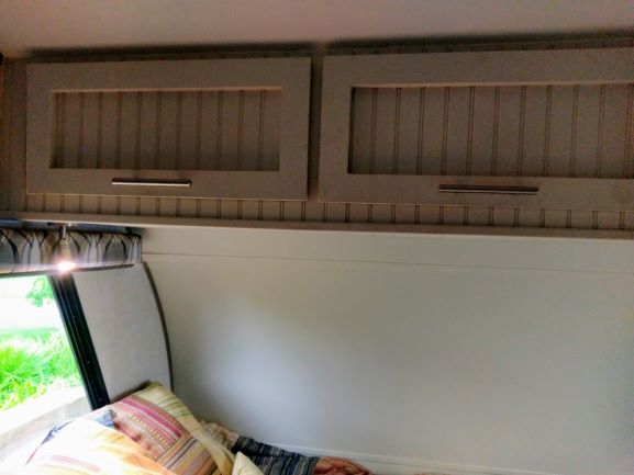

JR ![]() Senior Member ![]() Joined: 31 Aug 2018 Location: Manistee, MI Online Status: Offline Posts: 390 |
Jay
179/2019 |
Nice work JR! Great job of matching up the vertical kerfs I'm sure that looks a LOT better than our bare wire! Vann
