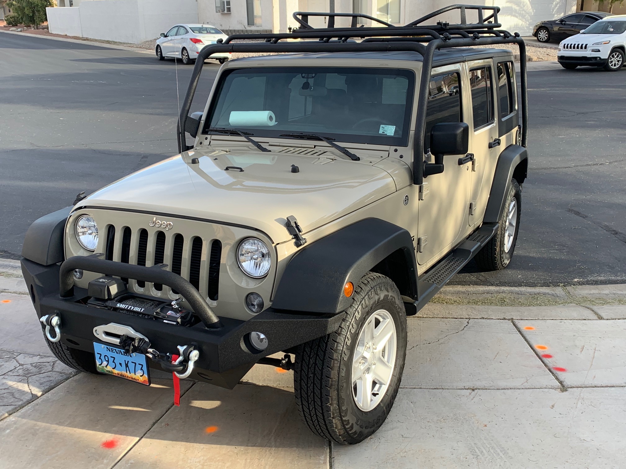

Nice looking Jeep.
But If that’s what you’re planning to tow the 189 with then it’s undersized. It has a 3500 lb tow rating, right? 350 lb tongue rating? And those are with no passengers or gear in the TV. The 189 loaded is going to weigh closer to its 3859 max gross weight and tongue weight will be closer to 500 lbs, especially if you plan on boon docking, with water, batteries, maybe a generator, extra propane, etc. etc. You’ll want something with at least a 5000 lb tow capacity to safely and comfortably handle that trailer. I do and I still have to load cautiously and keep things light.
Just sayin’. Load up both the tow vehicle and trailer and get your actual weights. Pay close attention to the total rig weight in comparison to the MCGVWR and to tongue weight. The wdh does not allow for an increase in tongue weight, it only rebalances it. Decide for yourself how close to the vehicle ratings you want to operate, but not over. Stay safe and legal.
You certainly have the skills to set up your wdh. Put a piece of painters tape on the front fender on each side. Find a dead flat parking lot. Measure from the ground to each of the tapes. Hitch up the trailer. Measure the front fender heights again. They will be higher because the rear of the TV has been pushed down. Now tension the wdh until the front fender heights are back where they were without the trailer, or just slightly lower. You are not trying to get the TV to “look level”, the rear of the TV will be lower than without the trailer when you’re done.,
Then measure from ground to bottom of the trailer box front and rear. If those measurements are within about a half inch or so then the trailer is level and you’re done. If not readjust the hitch height to get both the trailer level and the front fender height where you want it That’s it.
