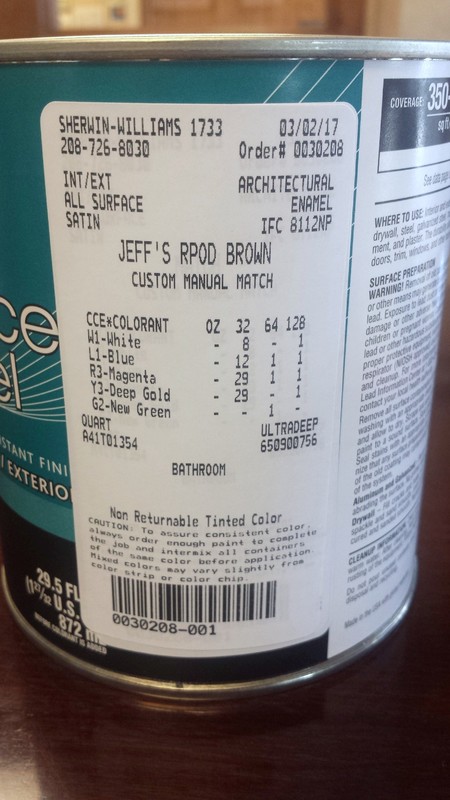

I see that there is a Sherwin Williams store in your area.  I'd suggest you take a sample piece of "wood" to them and give them a coupe days to mix up a stain for you.  I did it and was pleased with the results.  I've shared the formula a number of times here.  However, they no longer carry the base color needed for this formula.  When I run out I'll have to take another sample to them to match.  Just an FYI, if you use their stain you will need to coat your projects with 3-4 or more light applications to build up a color that matches.
If your interior is that nearly impossible to match yourself dark brownish, grey tinted color then while you're at Sherwin Williams ask them for a quart of "Jeffs Rpod Brown" paint.  A few years ago another member of this forum had Sherwin Williams create a latex paint to match and last time I was there the formula was still in their computer.  It's a pretty close match.
