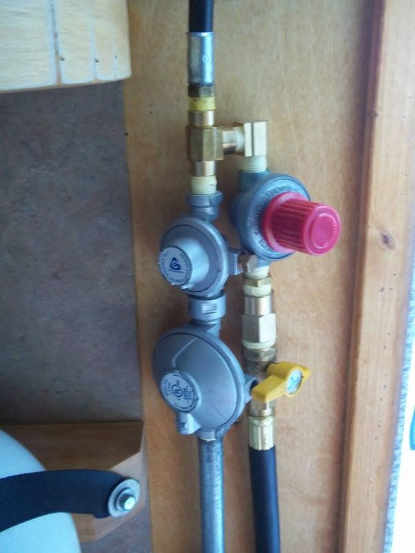

Here is my setup, one reg. for the pod and one for my quick connect outside.

As you stated, you have a grill with a regulator, and the pod propane connection is regulated. So a double regulated hook up will not work. Your choice is either remove the regulator from the grill and NEVER attach it to any other supply (it will be unregulated) or don't run it off the pod. Plenty of youtubes on this. I seen one that they put a quick disconnect on the grill regulator, so it's easy on, easy off.  Me, I carry a blackstone (flat top) and a weber Q grill, and I run a tree off a 20 pound between them. I like to save my propane for the h/w, fridge, etc..
