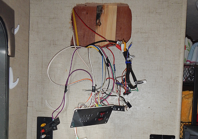

Just a thought, if you haven’t removed the Jensen stereo yet to check it out you may want to do it before you do any work or buy any materials for your mod.   We also have a 2016-178 and planned to do the same mod.  I’ve taken that Jensen unit out numerous times for a variety of reasons and I’ll be darned if I can find that rear AUX port.  I know, the owner’s manual shows an AUX input on the rear of the unit, you can even switch to that AUX port on the front, but it just doesn’t exist on my unit.  How can that be?
Now, if you already have taken it out and have located that pesky rear AUX port could you share a picture?  I’d love to know where it’s at and how I’ve managed to completely miss it all these years.
As an FYI, (see picture) the Jensen unit is actually deeper than the depth of the wall cabinet.  The good folks at FR roughed out a hole in the wall (with their eyes closed) for the stereo to poke into and the rats nest of wires to come out of for all the electronics.
