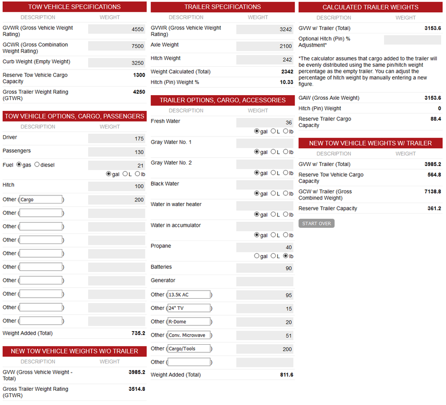

All this being said, I've done some calculations to get as best an estimate as possible of the max towing weight (including cargo, water, battery, etc.) and I am pushing the limit but still under.
Obviously this isn't ideal but all things considered, if I added a weight distributing hitch to make sure everything was balanced... how do you think this would handle? I plan on most of my camping to be at sites with full hookup so a lot of the weight I calculated in will not be there. Below are the weights and calculations. Floor model is RP-171

Can you please elaborate on this? I see this as a typical response when responding to tow capacity questions but the numbers I've calculated are not 'dry' numbers. I've generously calculated cargo, water, gas, batteries, LP, etc. as you can see in my original post. In fact, the cargo carrying capacity of the trailer + the dry weight is less than the towing capacity of the vehicle so I'm not sure how I will blow right past it.
Again, I'm very new to this but have tried to calculate everything I will be pulling in both the truck and the trailer. So can you please let me know what else I might be missing?

First, let me say that I'm impressed with how thorough you've been with your evaluation. Usually new owners find out all this stuff after they buy their trailer or tow vehicle. So, great job,
Looking at your numbers, I think your added 811 lbs is not conservative enough. I have dual GC2 batteries and a single propane tank. Dual GC2's weigh in at about 130 lbs (not 90), so that would make your 811 about 850.  My 179 weighs about 950 over dry weight when I fill my fresh water tank. And I try to carry minimal tools and "stuff" in the trailer. Things still add up. For example, 90% likely you will want to get rid of the crappy OEM mattress and get a higher quality one which is going to add 20-30 lbs. Bottom line, as you obviously plan to boondock, I'd suggest you plan on around 900-950  over dry weight, which not coincidentally puts your trailer right around its max gross weight.
On to your tow vehicle. The smaller weight distribution hitches don't weigh 100 lbs, more like 60-70 or so, so you can save a little bit there. Curb weight is supposed to include a full fuel tank so there's a little more savings. I suspect that you'll have more than 200 lbs in the truck bed though. If you're boondocking you'll either need a generator and fuel (say 100 lbs) or a solar module (say 20-25 lbs), or both. There will be other stuff too. Firewood, a grill, the list goes on.  So maybe that washes out. Since you already have the Taco you could load it and take it through a public scale and then you'd know what it really weighs.
Putting it all together I think you'll be maybe be couple of hundred lbs under your GCWR. That's not a comfortable margin but you could try it (driving very judiciously) and see how it feels.
Where you will have more of a problem is on tongue weight. The propane tank, dual batteries and fresh water tank will probably roughly double your tongue weight, Mine did. If you're really limited to 350 lbs then that is a problem and its not solved by a wdh. The hitch transfers weight to the TV front axle and to the trailer axle but it does not increase your tongue weight rating. If you're right and the tongue weight has been derated for power reasons then maybe you're OK. I'd try asking on one of the Toyota forums and see if anyone there knows the real story.

Thank you for the thorough response. I actually do NOT plan on boondocking often, if at all. I just tried to add the max amount of stuff for worse case scenario. I didn't know curb weight included gas but I did just read somewhere that it was suppose to include 150lb driver..  but that also said empty tank... who knows. As you suggested I may check on a taco forum for clarification.
I am well aware that the hitch alone does not add any towing capacity (would actually reduce it slightly due to the additional weight) but the point I was trying to make which you've hinted to is that the other models with a hitch have much higher tongue weights. This leads me to believe that it is either limited to 350 off the bumper or rated that way because of power.

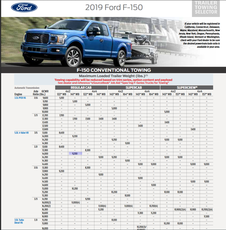

The 4.56 gears will give me a big advantage when it comes to towing over the 3.307 at the expense of fuel mileage and rpms. For example (see below) the F-150 towing capacity is significantly increased as shorter gears are used.
The thought is that the hitch will give me a little leeway on the tongue weight and the gearing will allow me to tow at or near the max capacity without lugging the engine too much.
