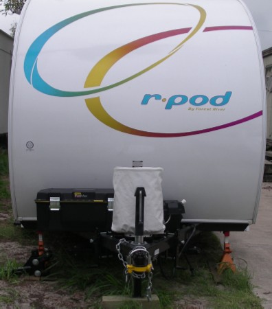

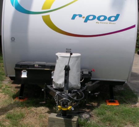

Direct Link To This Post Posted: 31 May 2010 at 9:26pm
Here are the before and after pics.
I also use the 1 lego block and lego cover to give the stabilizer foot a solid base.

Direct Link To This Post Posted: 02 Jun 2010 at 11:00am
ClapGerald:
Yep I hated having to go to the back of the pod or into the truck for things I needed to set up or take down (back up balls, locks, hammers all fit very nicely).
I used a Stanley waterproof tool box (actually I've pickup to others one for r-dome parts and one for the tricycles hemlets and stuff).  I was thinking of getting a small luggage rack where the spare tire is, but with all the bike rack problems I'm going to rethink that for now (May have something welded to proide support).   Next year I'm hoping to go to some of the National Parks, and may replace the Battery box with another toolbox that will hold two batteries.
Tip 1: Be sure that you bring your box forward enough to open the tool box.
Tip 2: Don't forget to get to have something to close off the batterybox when you take out the key, Tip 3: You might as well ( your working on the batterybox) drill a couple of drain holes in the bottom, some people had water in the battery box last year.
Here's a link on the tool box, and battery cut off switch I did last year.  Yes I move the batterybox over as far as I could although I don't think I mentioned it,
Good Luck and Have Fun and Happy Podding
