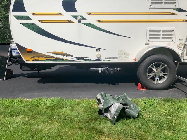

Posts: 2595
Posted: 21 Jul 2020 at 3:21pm |
Looking at the photo reminds me where the tanks were. Black and gray forward, fresh aft. Sorry for the bad memory. It's been almost a year since we sold our 172.
