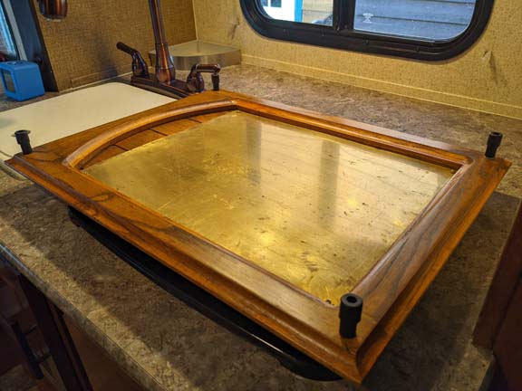

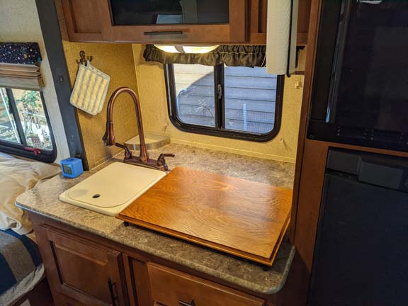

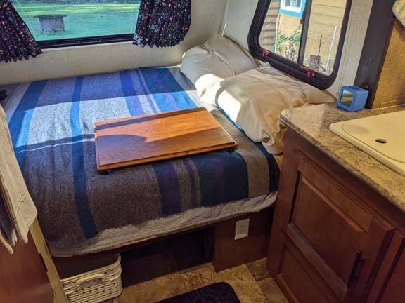

My VERY first Pod Mod in my 178 seems to be a success! This stove cover is a cabinet door with a recessed panel that I found at the local building supply recycler. The feet are soft rubber (so non-skid) bumpers screwed on with a plastic shim to make them the right height -- about 3/4" above the burners. Then I cut a piece of sheet brass (I KNEW I would need that for something... 20 years ago) and screwed it to the recessed underside for a heat shield just in case the burners were still a little warm when I covered them. And when I'm cooking, the cover sits on the bed for extra "counter" space.

Very nice, well done.  Looks great!
