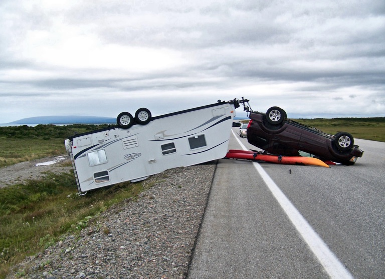

Direct Link To This Post Posted: 17 Jun 2015 at 7:22pm
Originally posted by bobditch
Damn!! I hate it when that happens.
PODSKI View Drop Down
Joined: 14 Jun 2015
Location: Green Bay, WI
Posts: 34
Direct Link To This Post Posted: 17 Jun 2015 at 7:29pm
Wow! Ouch! big trailer with weight distribution hitch and what kind of TV.

Direct Link To This Post Posted: 17 Jun 2015 at 8:14pm
Maybe an Xterra or a Pilot?
Uh oh I have an Xterra
