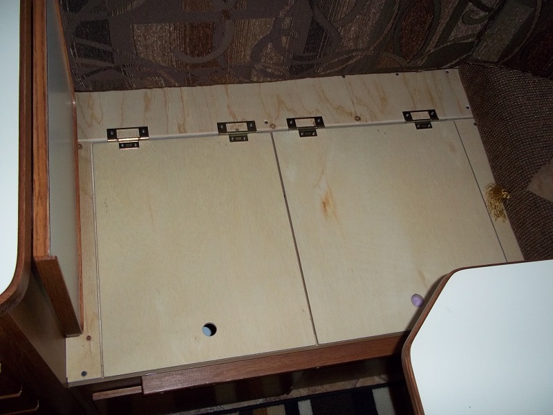

I made a built in cooler under the dinette bench. We put two 4 litre containers of ice in a tub, the ice lasts 8 to 10 days pending on outside temp

Post Options Post Options   Quote Kup-Pod Quote  Post ReplyReply Direct Link To This Post Posted: 28 Mar 2020 at 4:53pm
That is very cool!
If you don't mind me asking, what styrofoam did you use?  Did you have to "seal" the surface of the foam?  And did you put a drain in it or do you just wipe it out when you're done?
Sorry for firing the questions, but I definitely see a mod in my future? :-)

Post Options Post Options   Quote marwayne Quote  Post ReplyReply Direct Link To This Post Posted: 28 Mar 2020 at 6:02pm
I used the blue Styrofoam ( R 8 ) then covered it with laminate siliconed the corners. No drain we put the ice in a tub and what ever is wet we wipe it up
