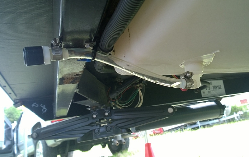

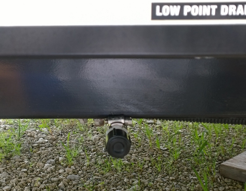

To make life easier when draining the fresh water tank, I extended the drain cap to the outside of the frame and used a zip tie to hold it to a clamp that retains a wire bundle.  The 1/2" nylon fittings are available at Home Depot.  In the picture, it appears that the cap is above the bottom of the tank, however it's actually at the same level as the bottom.  The bottom of the elbow in the tank is about 3/4" higher than the original setup.   Problem solved!

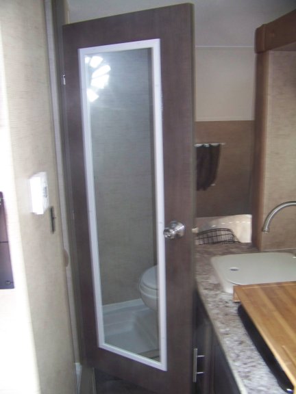

A couple of items we've found recently that might be useful.
Found a plastic framed metal wall mirror at  Lowe's for $6. Weighs around 5lbs and is indestructible. Screwed into the inside of the bathroom door with #8 wood scres (heads painted to match) and caulked: http://www.lowes.com/pd_33107-28392-72462_1z11oomZ2z8vj__?productId=3698032

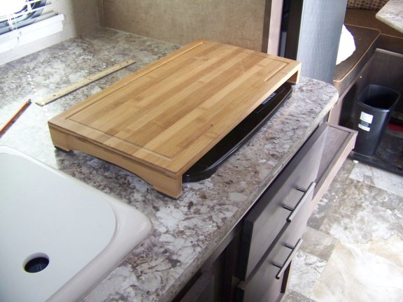

Found a bamboo cutting board for the range cover. Glued on 1/4" spacers and then some rubber non-skid pads to get the proper clearance (1-3/4"). Costs between $15 to $25.  Google: "Lipper International Bamboo Large Over the Sink/Stove Cutting Board" for a local price. A little wider and a narrower than the range top but works very nicely and stows on the counter behind the stove.

really nice cutting board!
