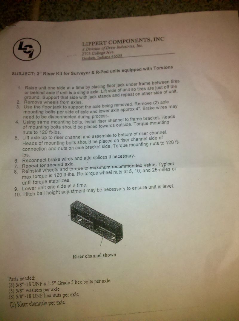

Mine was built in the second half of the 2011 run also, and did not come with the riser.  I just put them on myself yesterday.  Maybe your dealer installed them?

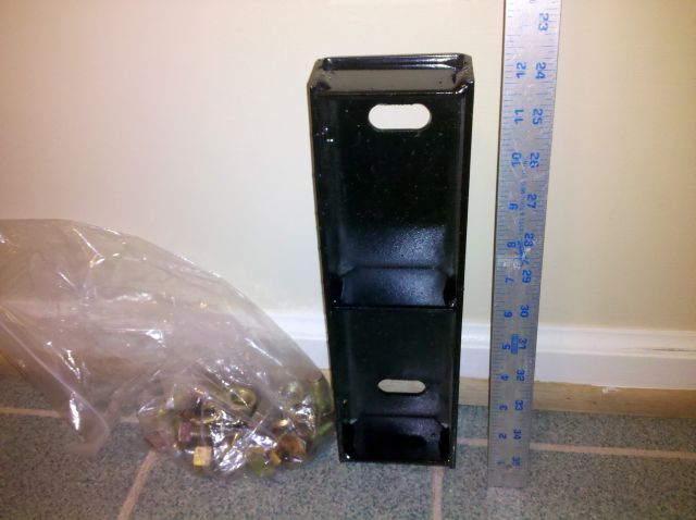

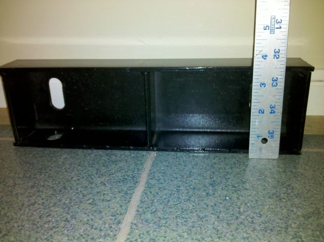

Maybe, it should be on the bill of sale or invoice, though. You can check yourself. The risers are rectangular black painted steel forms about the size of a 2x4 and 8 inches long. They bolt in place between the trailer and the axle and should be obvious.
