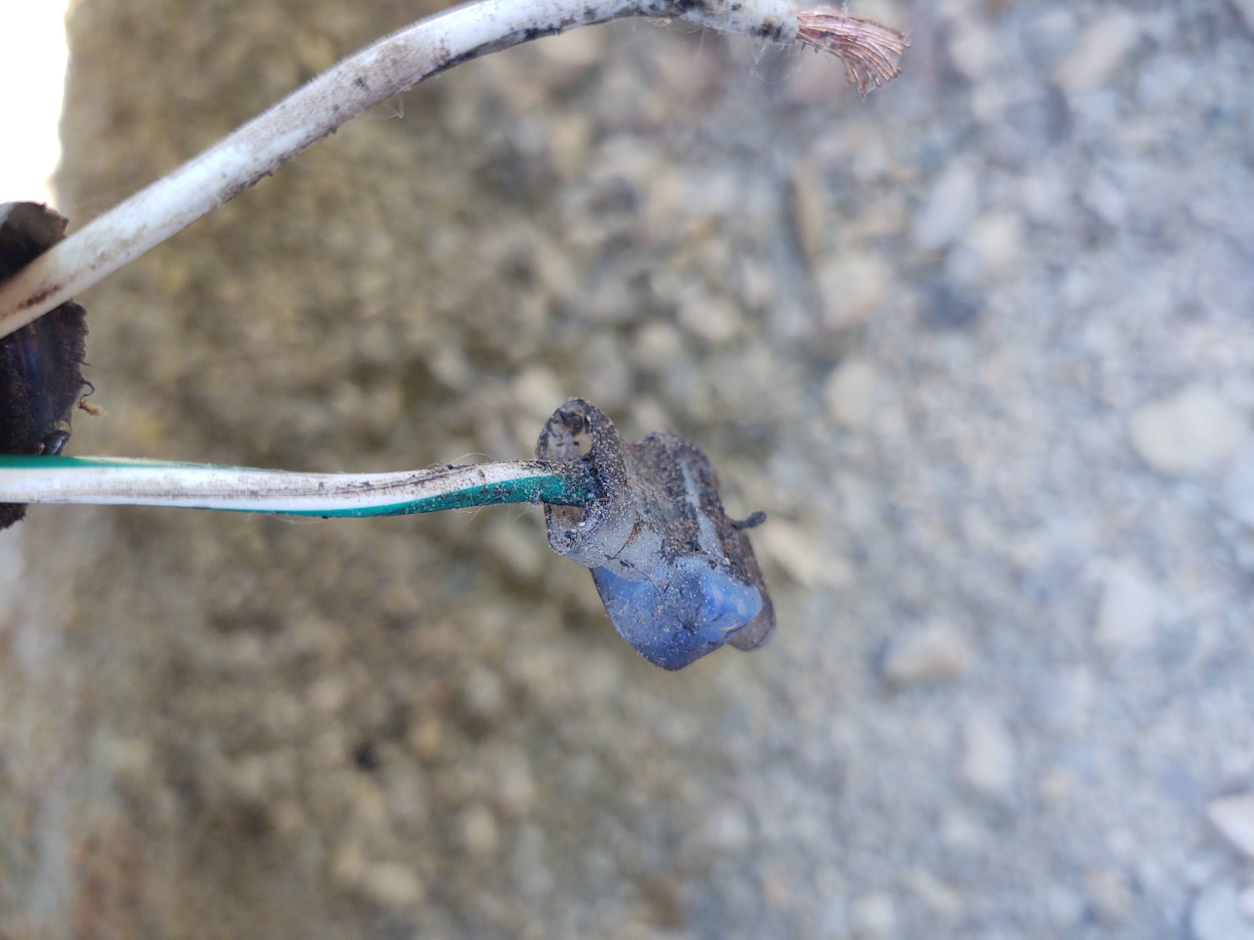

No not exactly. I have some like these in my normal stock actually. The factory ones looked like this and the wires all enter the same side and you would use basically a normal set of pliers to make the connection, strip the wires and seal the whole deal. Update: well I can't find the photo I took. It looks a lot like the scotch lock connectors the phone company used to use back in the day but larger and for larger wire. I'll look for a photo and post it as soon as I can locate it. Update X2: Found the picture I was looking for, which ain't great. Maybe post another better one tomorrow. ![]() |

Hard to tell what that is but it looks like a wet location wirenut. Those are used for home wiring in wet locations and are gel filled. You can get them at your local big box. I wouldn't use those though on a vehicle because they are twisted on and the vibration could work them loose. Just because FR uses something that doesn't mean its the best approach. They use a lot of "insulation displacement" connectors and those are terrible. They save them time in the factory, that's why they use them.
Properly installed heat shrink adhesive filled butt splices are a better solution. Just be sure they are crimped correctly before you heat them.

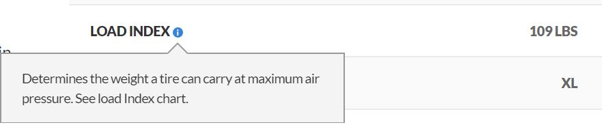

Load rating seems a little low ![]() ![]() |

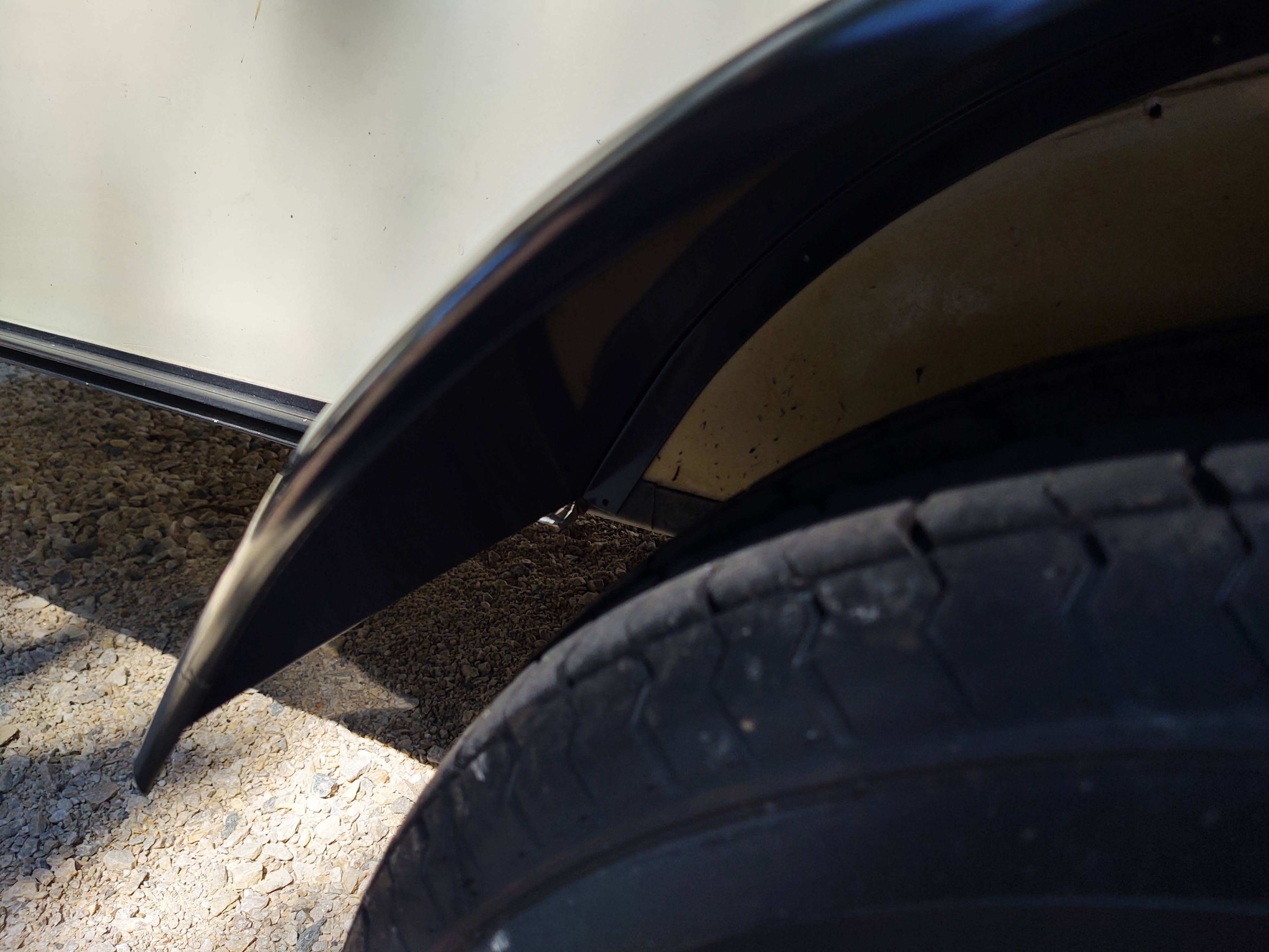

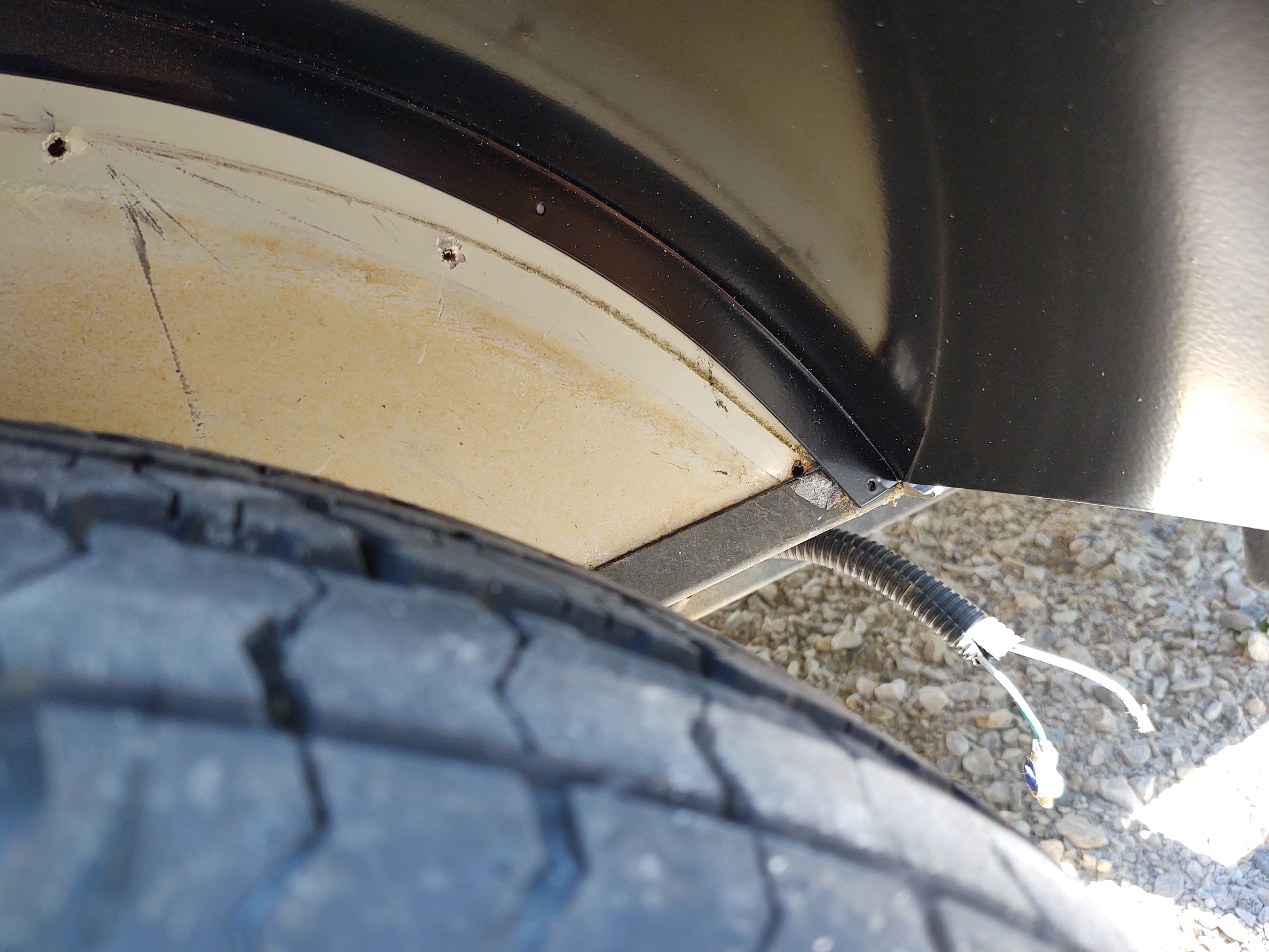

Thank you I am so glad you posted this. I just went out and tried to size up the new fenders to the old mounting area and they do not match. If I put the front and rear edges of the replacement fenders even with the bottom edge of the camper floor, the apex sticks up a good 1.5 inches above where you can clearly see the old one was mounted. I"m guessing that it is no going to make that much difference since it looks like there is plenty of wood behind the entire area and the apex is still about 3 inches under the bottom of the slider. On the door size, I will just put the fender between the two rails for the r-dome skirt and that's where it will mount. It is centered on the tire at that point. Bottom line is this. I just need to fill the old holes as for the most part I will be making new ones for the new fenders. =) |

It looks like I'll be making new holes as the fenders they sent me are a little taller than the ones that came off of my 2016 RP178. Not so much so that I will be off-wood but new holes will be better. I'm guessing I can fill the old holes with the 3M 5200 and be fine with just that? I planned on putting some on the threads when I ran in the new screws but I'm not sure I need that since the holes will be fresh also. ![]() ![]() Well Hmmmm. I have a 3rd photo to post. It shows up in my file manager after having uploaded it like 5 times and not seeing it in the left side of the add image dialog, but it doesn't show up in the add image dialog... so I don't know what to do to get it here. |

Sure, if you just run a bead of 5200 over the mating surface that should seal the holes fine. Clean things up first of course. That fender isn’t coming off after that, not without taking the Fiberglas with it anyway...
