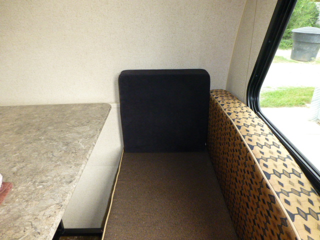

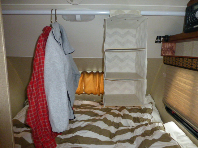

We have a 177 and the clothes hanger over the bed was to low even after moving it  higher.  I removed it and got a closet rod to go the full width of the trailer.  Now the clothes are up out of the way.  I also got a six shelf hanging closet organizer, cut it down to three shelves and hung it on the rod.  It can be slid  along with clothes to the foot of the bed and be out of the way.
i also removed the microwave/convection oven and now use the area for storage.  I put in a removable shelf and slats to prevent things from sliding out.  The door size is 18x24 and I found a black artist canvas on a frame at a craft store.  Used self closing hinges and a black knob.  If you were artistic you could get it in white and paint something on it!
Also at a sewing store I go two foam cushions 18x18x4 and my wife covered them in black.  Since the front wall curves in these move a person out enough to sit length wise on the benches.  I like that for watching a movie.
These projects along with mods I have seen on this forum have greatly increased the functioning and comfort of the pod for us

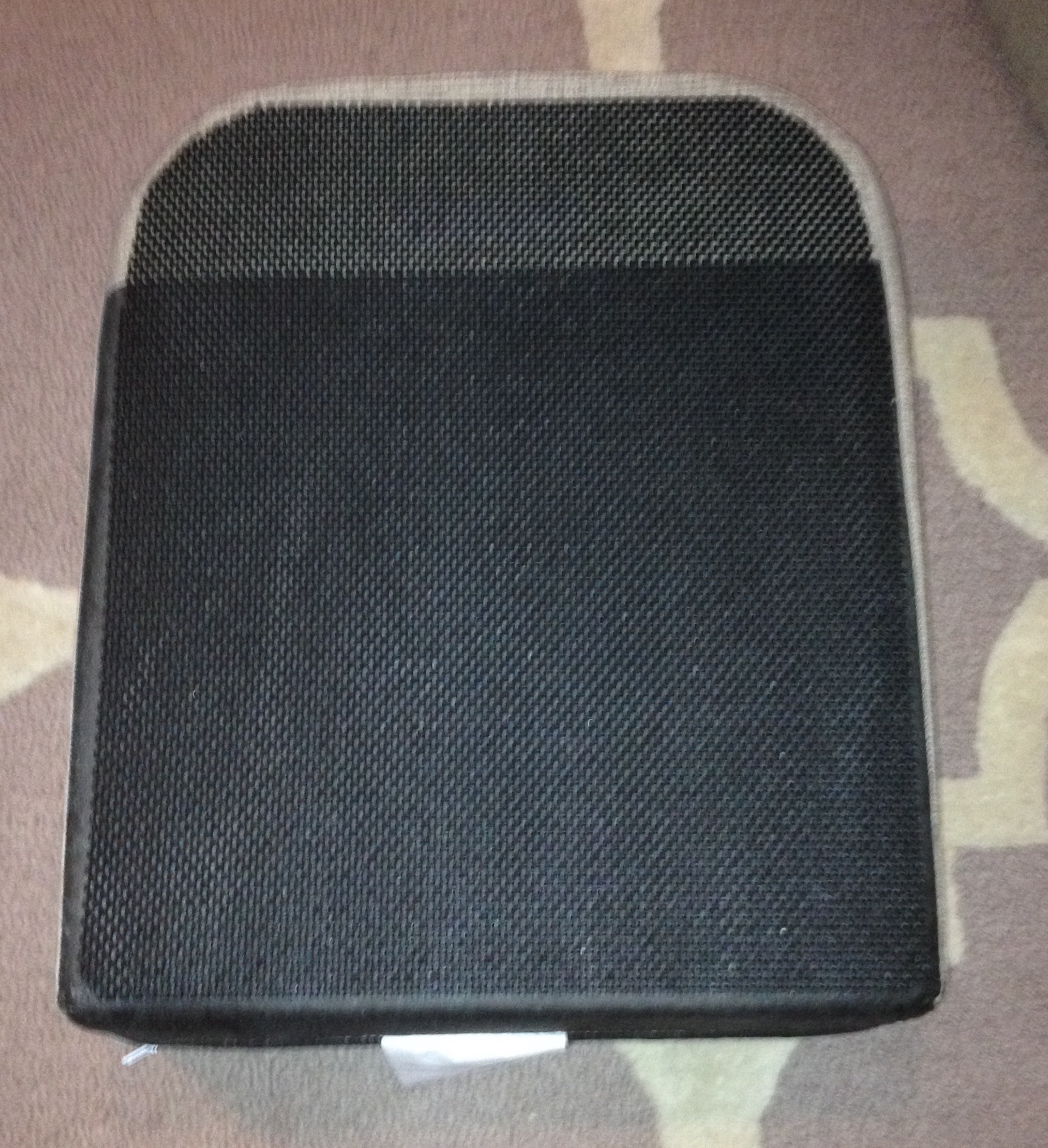

Here's my solution for fixing slipping wing dinette cushions on our 179.  Photos attached.  Buy some heavier duty shelf liner.  I bought black.  Cut to fit outline of cushion and just a little smaller.  Apply 3M Super 77 Pray Contact Adhesive to liner and bottom of cushion.  Let set for 1 minute to get nice and tacky.  Apply liner to bottom of seat cushion and let cure for 30 minutes.  My advice is to only buy the 3 M product as it is clear and will not soak into the material.  You want it to stay on top of fabric so you get good adhesion.  Other brands are colored and will soak into fabric so you have to put on multiple coats to get a good layer of tacky finish.  One even coat of the 3M product will be sufficient.

I thought about doing the same thing, only using those rug gripper thingys, cut to fit the size of the cushion, but not attached to the cushion itself.
