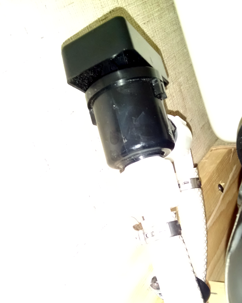

Two things lead to damp toilet paper. One is forgetting to take it out of the shower first. The second is (at least in the RP-179) the black water tank flush seems to have a backflow prevention device that will leak water when the pressure is removed. I was wondering why we had a wet roll since we had not forgotten to remove the roll. Then I saw the device on the blackwater flush line. The next time I used the flush fitting, I checked. Sure enough, there was water in the shower area. This time, I had removed the roll first, so it stayed dry.

On our R-179 I have used the black water tank flush several times and I have had no backup into the shower, sink or anywhere else.

The black water flush port is on the side near the door above the fender. To use it, you simply connect a hose to it and turn the faucet on. Don't use your fresh water hose! You don't want to take the risk of contaminating it. Use the BW flush to spray water in the BW tank while you are emptying it. It will help flush out things that the initial dumping misses. While not recommended, you can close the dump valve and let the water run to fill the tank. If you do, monitor closely so that you pull the dump valve and empty it before the tank fills to overflowing. This will help clean off the sensors also.
Depending on what type of tank treatment you use, you may not need to use the BW flush every time. Some products use bacteria and enzymes to help break things down. Some of these specify not to flush the tank every time so that the bacteria presumably have something on which to work.
As for the water escaping from the line, it is clear water, not sewage. I think it is when pressure is released. I am going to take a closer look at it and try to get some pictures, which I will post.

Okay. I got a picture. The black object is what I am talking about. It does not leak while pressure is on the hose. However, when pressure is removed, I have seen water, and it appears to be coming from this device. The reason I know this is that twice I have ended up with wet toilet paper. I know the sink is not leaking. It only happens when I flush the black water tank and then, only after I am done and turn the water off and release the pressure.
I would appreciate it if someone else would also take a picture of that is on their 179. Does it also show evidence of water when the flush supply hose is disconnected?
Edit:  Don't bother with a picture. I found out what it is and now know it is defective. It is a Vacuum Breaker/Check Valve. It is to prevent backflow of black water into the hose and water system being used to flush the tank. It is also to prevent siphoning of black water out the flush port if the cover should become loose during travel. The fact of it leaking means I need to replace it. I am looking for alternatives to this plastic part which is way overpriced. I am thinking of this one. Does anyone have experience with it? Is it more reliable?
