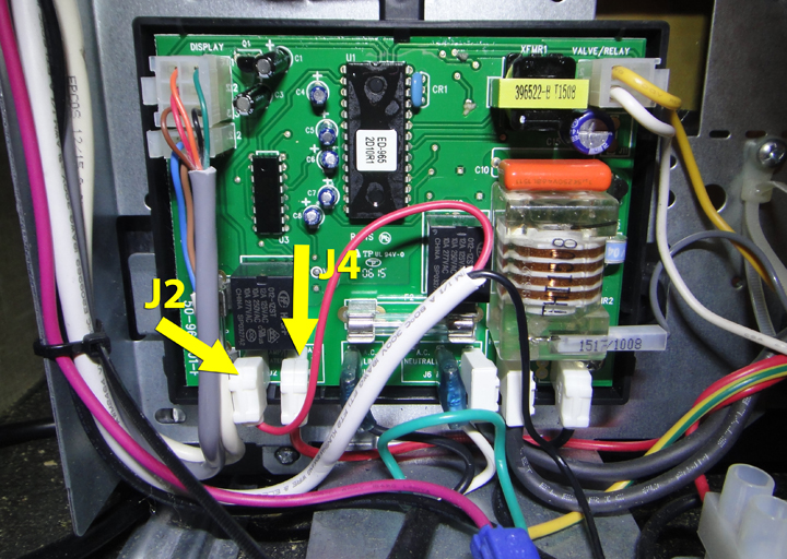

Holly,
You definitely are presenting a problem. It appears from your picture that the heater and light are hardwired together like the second diagram in the RV.net post, labeled Appendix-C. To disable the heater and leave the light you will have to cut ONE of the red wires OR ONE of the black wires. Do you have access to or can borrow a clamp on ammeter? It will look like these and must measure DC current:
http://www.amazon.com/s/ref=nb_sb_ss_c_0_11/187-5915115-2539268?url=search-alias%3Daps&field-keywords=clamp+on+amp+meter&sprefix=clamp+on+am%2Caps%2C271
If so you can easily determine which red or black wire to cut. If not it becomes a guessing game. You could take a lead from the your second RV.net post (by Zackdog) and assume the larger wire is the heater. If you cut it and the light still works you've won. If not it can be repaired and you start over again. Or you could then go and cut the other and just live without the light. Another option is to identify J2 in the back of the fridge and disconnect it. This should disable the heater AND the light. I can't tell from the pictures what J2 looks like physically so I can't help there. If you can ID J2 and it can be disconnected that would be the easiest.

First tell me if you can get or borrow a clamp on DC ammeter? An auto store like AutoZone may have one to lend.
If not, can you locate J2 in the back outside like the Zackdog (RV.net) first picture? That would be the second best.
The third option would be to just cut the larger black wire as a guess. Cutting either black wire will disable the heater, though the wrong wire will also kill the light. If all else fails it's worth a try. You may get lucky and retain the light. Either way the heater will be dead, but you have to cut one black (or red) wire. Be sure the trailer is unplugged from shore power and one wire of the main battery is disconnected before cutting. I recommend cutting the black wire because you will not have a hot wire floating around. Tape the cut wires and sleep well.

Just pulling the silver or brass connectors from the lamp will not disable the heater. That just kills the light. You have to separate the two black or red wires from each other.

I FOUND J2!

Direct Link To This Post Posted: 17 May 2016 at 11:25am
Ok, now you have a choice. Wait for the clamp on meter and be able to disable the heater while retaining the light
OR
Simply pull J2, thereby disconnecting both the heater and the light.
