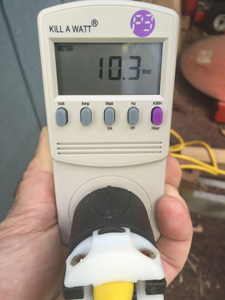

Direct Link To This Post Posted: 22 Sep 2015 at 10:18am
Just to follow up...
At the 24 hour mark The Kill-A-Watt measured 0.26 Kw. Calculated to 10.83 watt average over 24 hours.

Direct Link To This Post Posted: 21 Sep 2015 at 5:27pm
You're welcome. I'll keep the Kill-A-Watt inline for a day or two and we'll see. (It measures cumulatively) If I have time after that, I'll make some measurements with fridge and anything else anybody might want to see. Curious if furpod's numbers are same as mine.

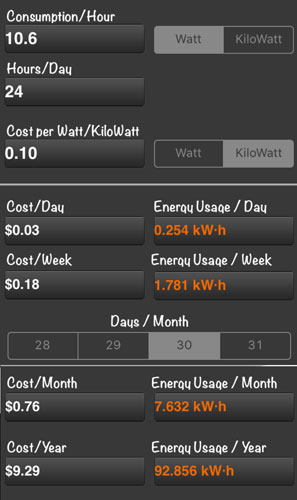

Direct Link To This Post Posted: 21 Sep 2015 at 3:08pm
Thanks fwunder! That's what I suspected. 10 watts is nothing when you're connected to shore power. That would cost about $.72 per month.
