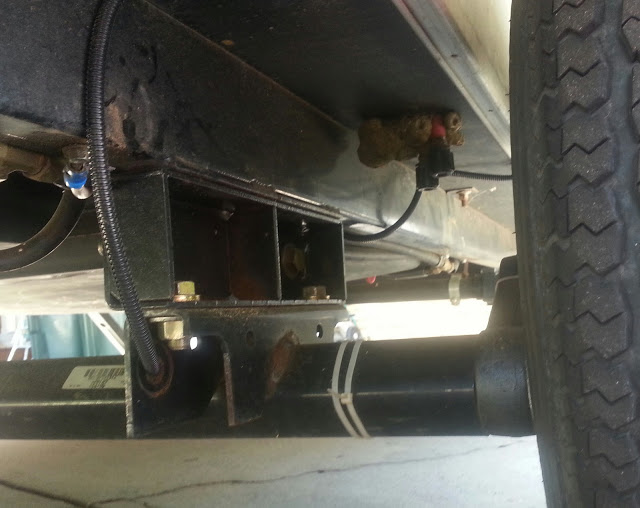

Heres my diagonal axle with flanges. Im wondering how many "styles of axles" are out there?
I'm still thinking about grooving a 4x4 with a 'V' notch to span axle and contact flanges.

Originally posted by Bill-GA
Levitation ,,, Schmevitation!
There are two different brands used that I know of. You could probably put a 2x4 block across the flanges on one side of the axle and jack there.

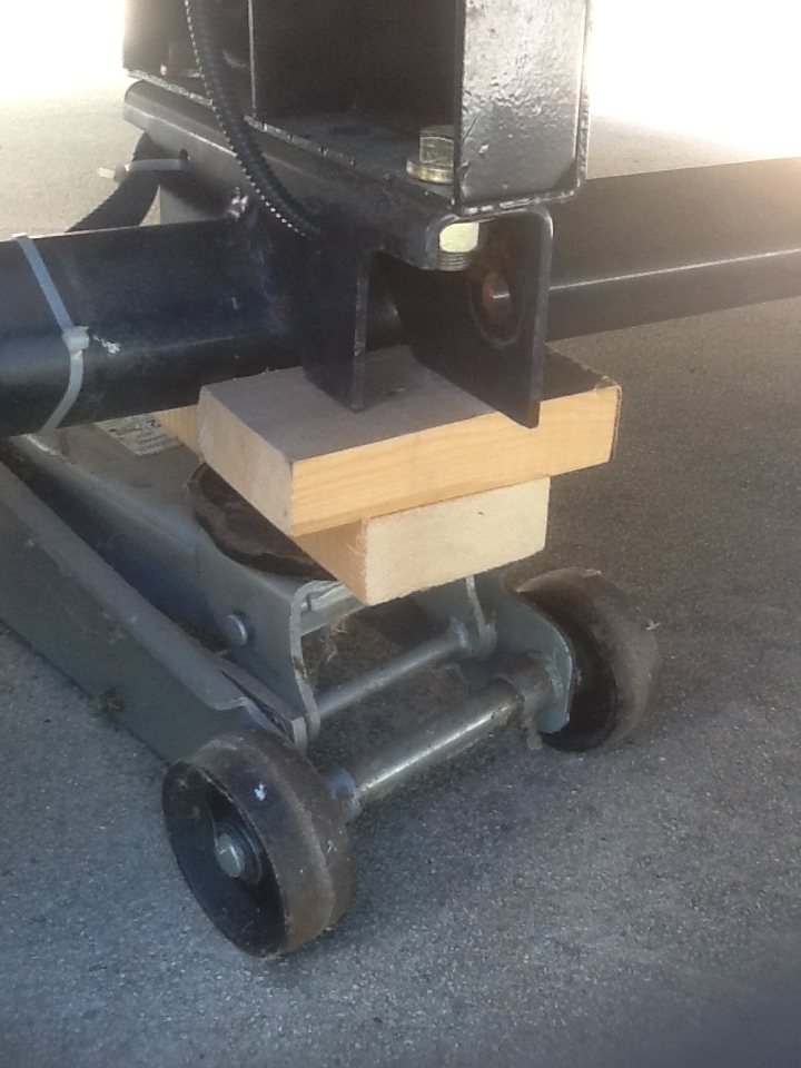

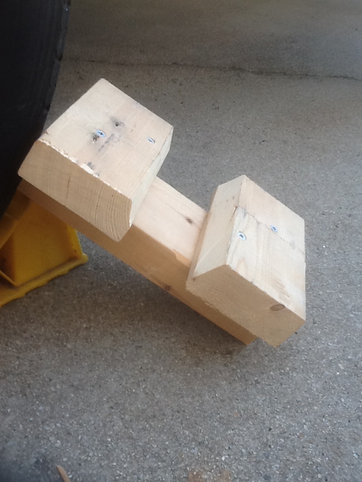

In response to the levitation supporters .... I finally made a block that bridges the axle and rests on the flange tabs on both sides ( from scrap 2x4's -  9", 6", 6") .... is this OK? or is levitation still the preferred model.
See how it supports both flanges on my DIAGONAL axle. Does NOT touch axle.
side view .... works great! I may replace the cross-over 2x4 with a 2x6.

Direct Link To This Post Posted: 26 May 2013 at 9:33pm
That will work
