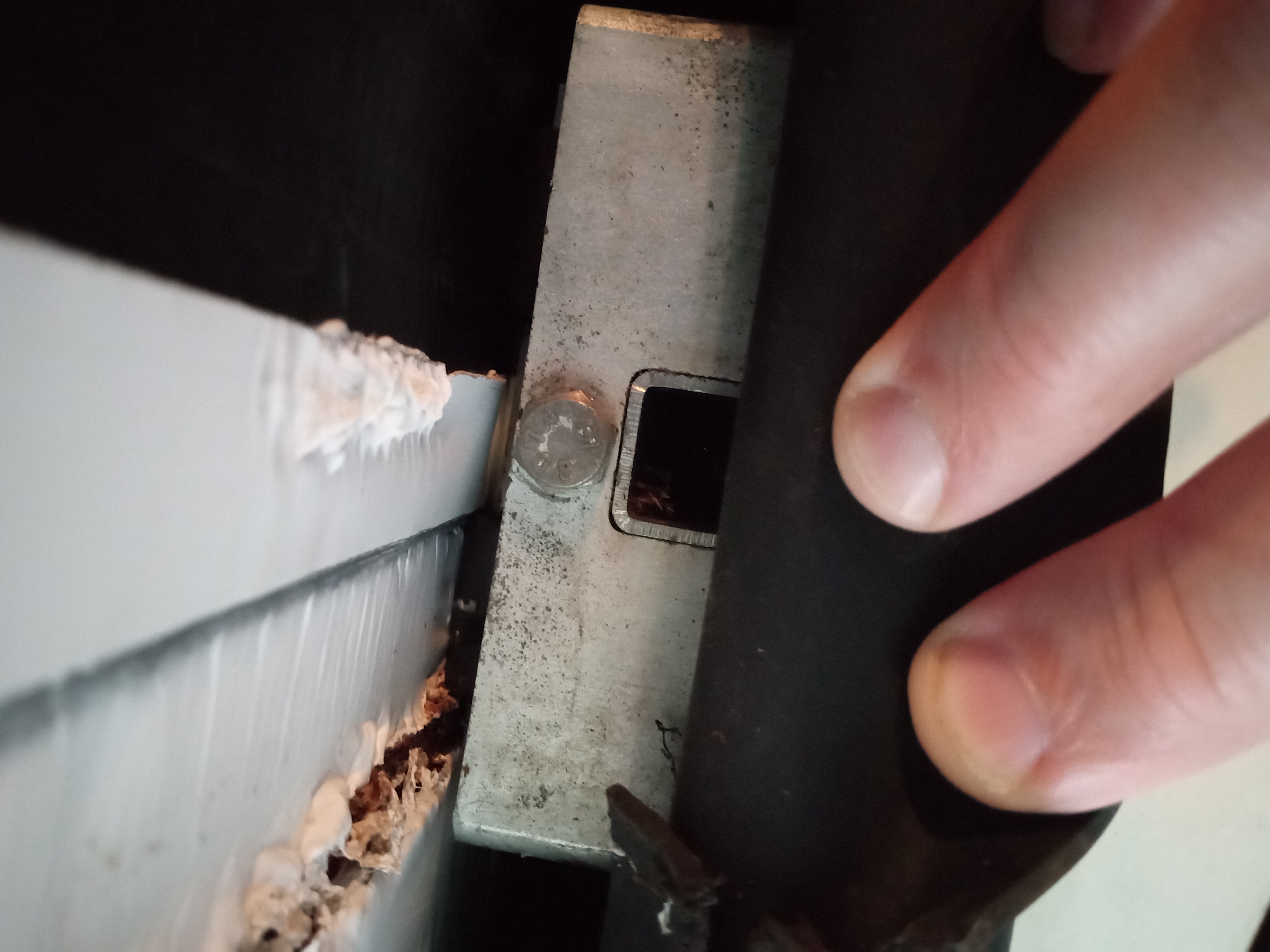

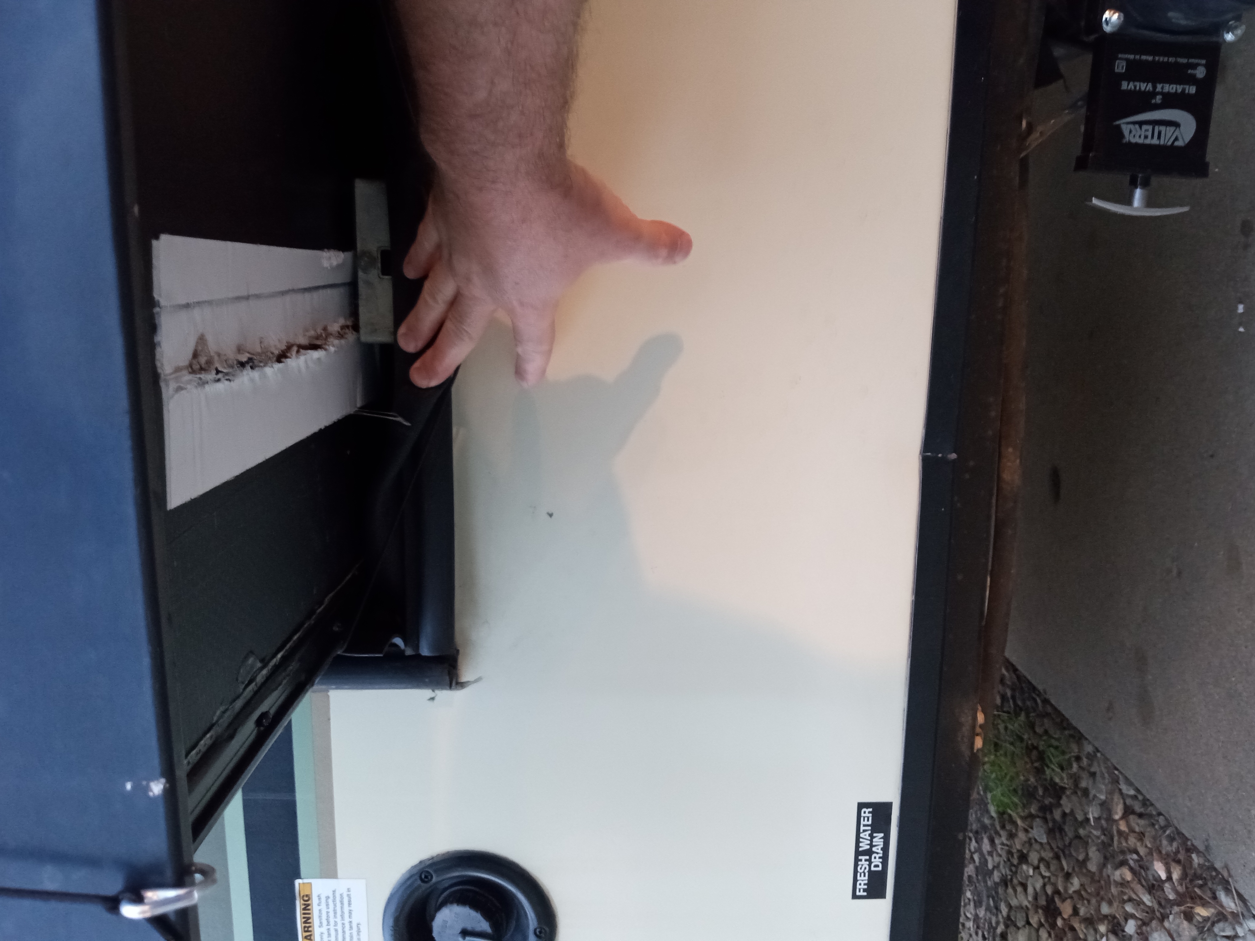

Mine adjusted with a socket and rachet. I just turned it clockwise and raised it up. The roller was adjustable on mine. It wasn't frozen up, I did lube it with triflow spray, though. I will get pictures tomorrow. With the slide out deployed, I could access the adjuster from the outside, I just pulled the rubber seal down and exposed the bolt.

I see a bolt but can't see the roller from the outside (difficult even from the inside). Yes, a picture might be helpful. Thanks!

i believe its a 7/16" socket to adjust it. i turned it clockwise and watched the roller go up. i just matched the height of the other roller.

Thanks... I found that too... I may have to lower the opposite roller assembly... awesome!

Post Options Post Options   Quote zzimmer3 Quote  Post ReplyReply Direct Link To This Post Posted: 28 Sep 2023 at 8:04am
you are welcome. you can see how mine rubbed pretty hard on the roller bracket. it looks like crap. it goes in and out much better now, i did lube it as well.
