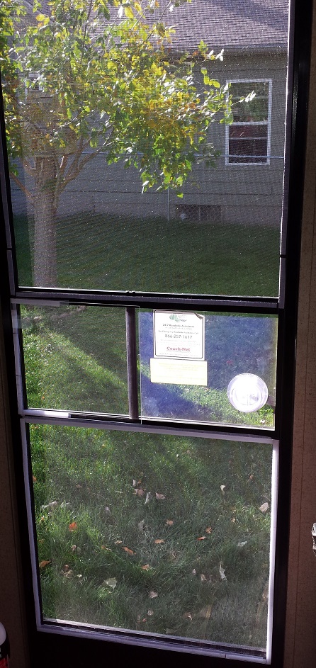

I love the natural light and added view when the door is open. I thought of adding a window to the door as some pod owners have done, but didn't think that would really add enough light and view. If only there was a way to cover the screens, air conditioned air could stay in, cold air could stay out and I wouldn't have to worry about my dog ruining the screen.  Using Plexiglas and velcro I now have removable panels to cover the door screens.  When not in use I store the panels under the bed mattress.
