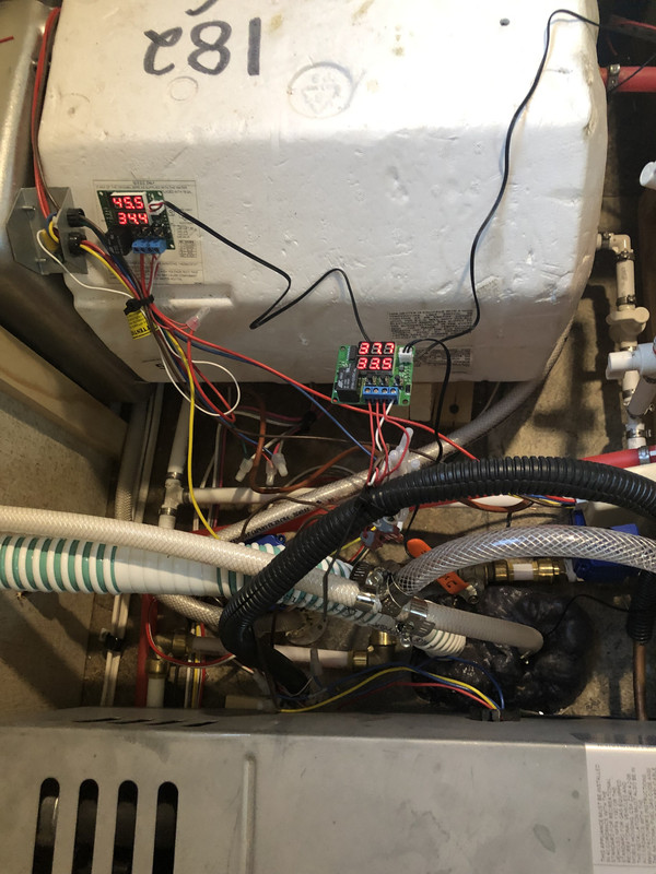

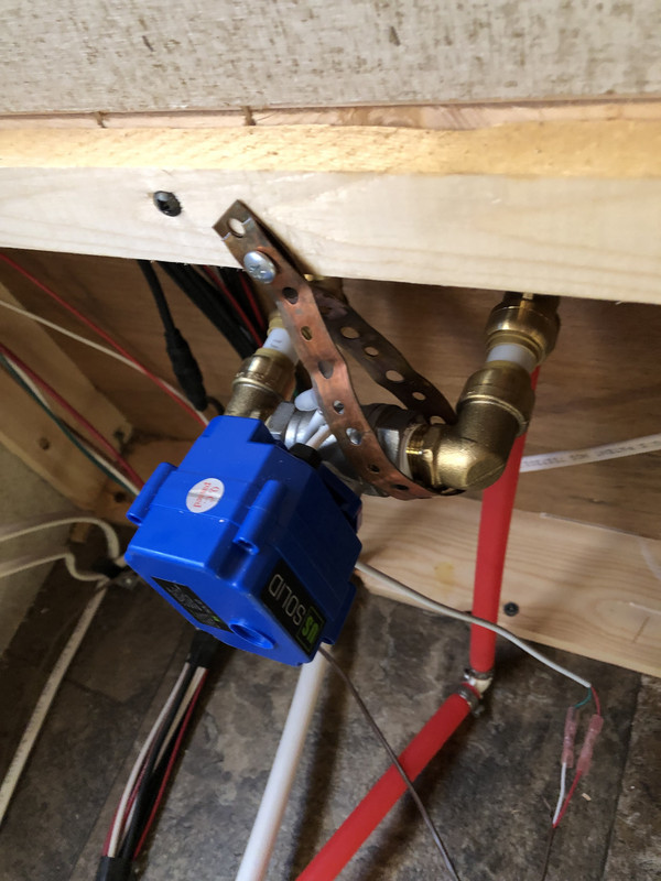

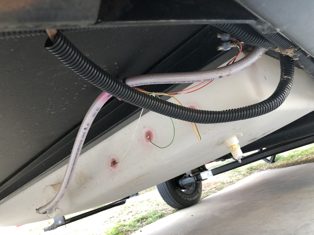

I have the recirc system up and going. I have tested some and it works. The placement of the thermostat sensor for a the recirc side is still ongoing. My first attempt was in a place too exposed and basically caused the water heater and pump to run continuously. I had my whole fresh water tank at 60 deg when freezing outside. No surprise then I am low on propane and it will be cold for several days and I don’t have time to test right now. So I wintrrezed the pod for now to focus on exposed pipes. The 182g has three water pipe exposures. Two are low point drains and I think I have ideas to insulate those as I can’t remove them. The third is the supply line that runs from the tank to inside the pod. It is about three fry long and totally exposed and is a definite problem. Scratching my head on that right now. Reroute maybe, insulate it triple? Not sure yet. That is definitely the place for the thermostat sensor.
The system runs from one switch. It is really a on-off-on switch called a dpdt with led indicators. When switched to red, the valve controlling whether cold water flows normally is closed. This also powers the thermostat that controls the two valves that allow hot water to recirc and return via the overflow line and ultimately the fresh water tank. I had some water spew from overflow so I had to reduce flow accordingly. I will post some pics.

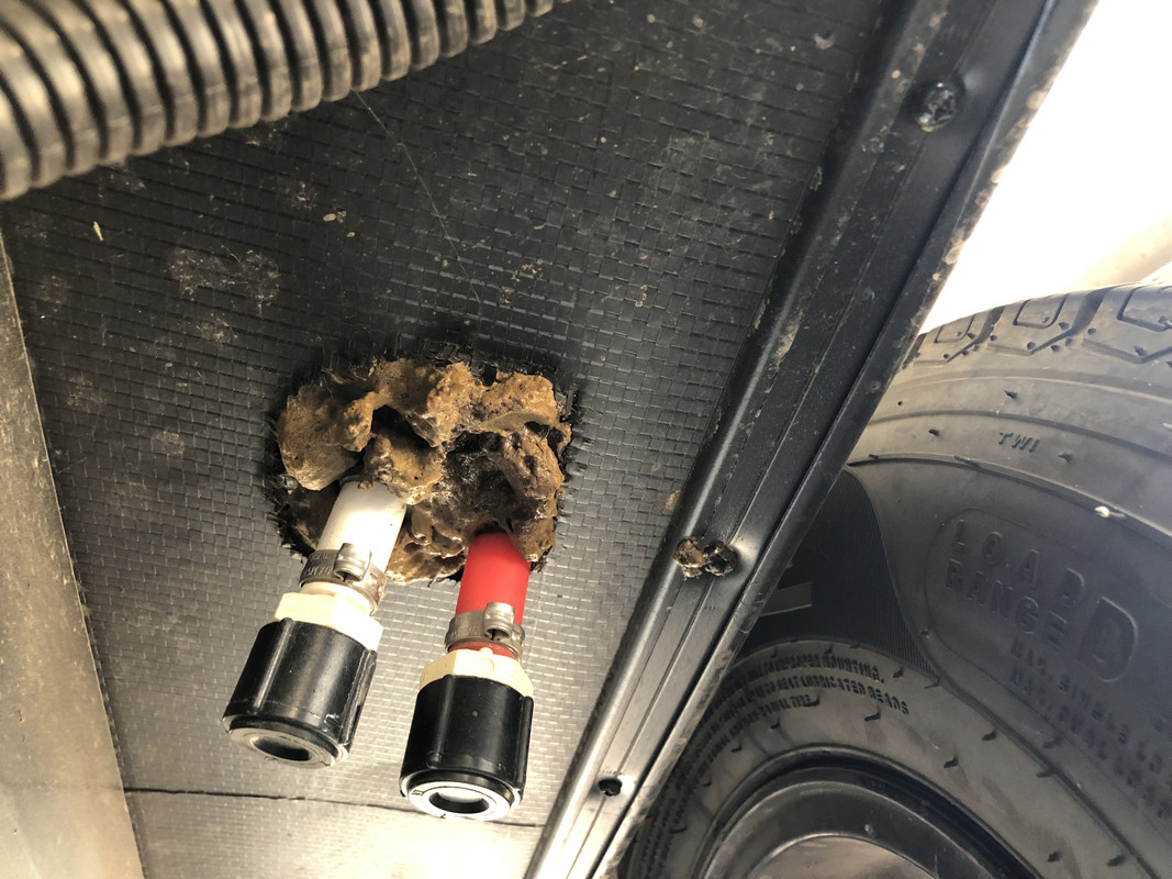

One of the low point drains. Other is almost identical
