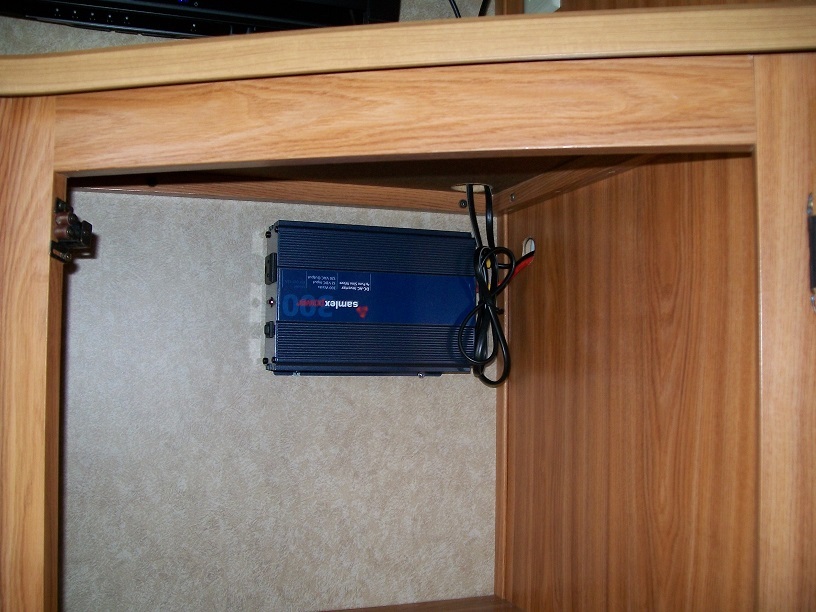

Direct Link To This Post Posted: 19 Nov 2015 at 3:50am
Originally posted by Rockin the Pod
 I guess one thought that comes to mind is running my generator at a more neighbor friendly time to charge my batteries and then use the tv to watch movies and stuff without bothering people.
That is how I approach the situation.
This is what I purchased & where:
inverter
I have used it for 3 or 4 seasons and it has performed well. While rarely needed for other than the television, it is nice to have 120vac available - if I do need it (without starting the generator). It does have a fan but, when the ambient temperature is cool to moderate, it rarely comes on. When it does, it is reasonably quiet. Being oversized for my 55 watt TV, it just isn't breaking a sweat. I have not put it on an oscilloscope to confirm how "clean" it is but, everything that I have plugged into it "likes" it. For the Ham radio operators among us, it is a bit RF noisy on the 40 meter band.
There are better ones out there but, price vs. what you get, I think it a good value. No regrets.
I mounted mine in my wardrobe closet, just under the TV, and ran a dedicated circuit - overkill but, what the heck. It should be fine running a small tv using the cigarette lighter plug.
