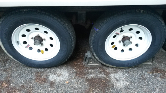

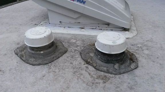

Two more upgrades, this time courtesy of the local dealer.  I bought the tires + wheels online and had them install them since they were greasing the bearings.  Of course they charged me $50 to swap the wheels even though they had to take the wheels on/off anyway to do the bearings.  Ummm, yeah.  I also had them check out the toilet, we were having an odor issue on the last trip and I thought a seal was going.  They thought it was just the sewer vent caps.  I could have done that for $10!  Oy.
I like the new tires, it felt like it rode better, didn't bounce around as much.  6 ply vs. 4 ply with the old tires.

My black tank roof vent is close to my bathroom fan opening, also. I've noticed when the wind is blowing right, I get vent odors if my fan is not running. I have to either close the vent or turn on the fan.

Vents - dumb design to put them right by the vent, yes!  But in this case we smelled sewer gasses inside the bathroom with the fan on.  The service tech said there was a gap where gasses could have entered the wall from above (??) so hopefully it is fixed now.

Do you have a recommendation regarding the tires you purchased? I am into the 6th year on mine and plan to replace them next spring. I have 6 ply now (made in China)and have had no issues.

[edit 9/25/16, do not buy Taskmaster.  The tread started wearing unevenly immediately and less than a year after mounting them two of them detonated within miles of each other (I had 2 spares, happily).  Replaced with D-rated radial (the ones below were bias) tires and after 8000 miles cross-country there was no odd tread wear. Brand is Duraturn.]
The tires are Taskmaster brand which I bought through eTrailer, pre-mounted on the wheels.  For older steel wheels I think that is the way to go - I worry about rust causing problems with the bead but that could just be paranoia.  I think I got duped though, etrailer said they were 6 ply which I thought was odd for C rated tires, but the sidewall says they are 4 ply + 2 ply on the sidewalls.  That is what I expect for C rated tires.  I probably should have held out and found D rated tires knowing now that I still only have 4 ply.  That said it felt more solid on the drive home than it did on the old tires.
