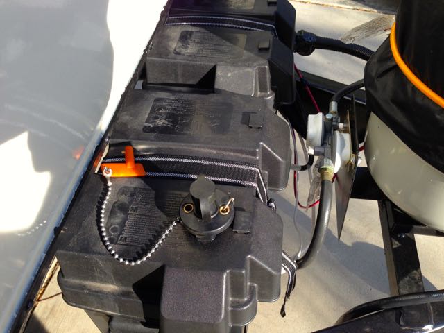

Yes. We also run 2 12vs in parallel.. We put ours in the top of the box..  I could have sworn I had a picture of the underneath.. will have to find it.. But the switch is just an in-line affair. Hook the cable from the trailer to one side, a cable from the battery to the other post. I have mine on the positive side, either works, both have advantages and disadvantages..

"We put ours in the top of the box.."
Very nice...clean mod. Does it hamper the inspection/service of the battery? How difficult is is now to completely removed the top of the battery case?

No problem at all. Unless by "completely remove" you mean "set lid on truck hood"... There is enough cable to move the cover up and out of the way. Battery maintenance is pretty minimal, thanks to the pod having a pretty decent converter/charger from the factory. In four years I once added about a tablespoon of water to most of the cells. Our pod is pretty much plugged i all the time, unless towing or boondocking.
