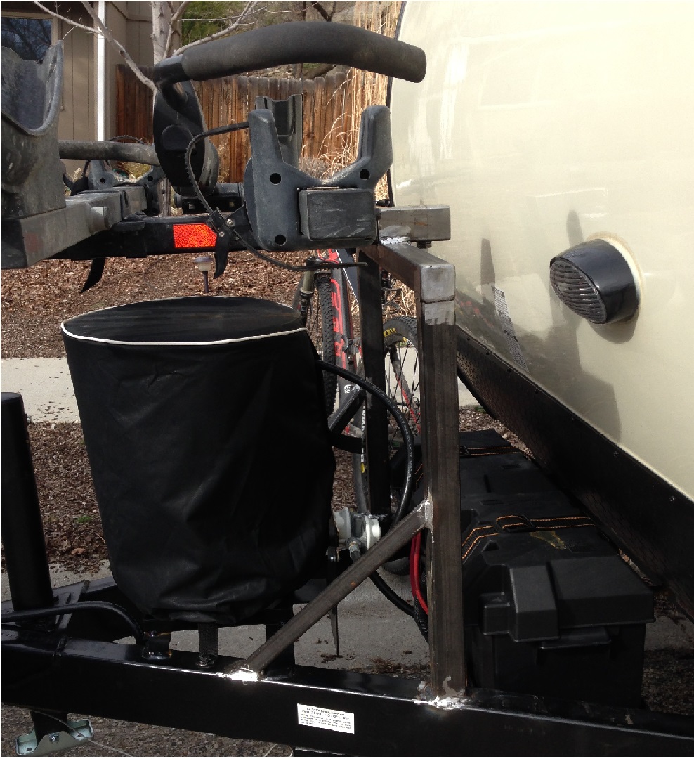

After seeing the posts on the Avrika tongue mount bike rack on this site this last year, I forwarded it to my dad who does welding to see if he could fabricate something for us. He was able to make a bracket that would accept two Yakima bike holders that are part of an extension for a four-bike hitch mount rack. I didn't want it to be permanently welded to the frame, so he was able to make solid brackets that bolt it on to the frame. This way, if we need the four-bike hitch rack, we can pull the two holders from the Pod and reattach them to our hitch rack. We finally had a chance to use it this past weekend, and it worked great. It is extremely solid and does not move or flex independently of the trailer frame.
The added bonus is that because 99% of our camping is dry camping, we usually fill our fresh water tank prior to leaving the house. With the 177, the fresh tank is located behind the axle (which has been my only complaint with the Pod so far). Despite the fact that we tow with an F-150, we would still get sway with a full water tank. The extra weight of the rack loaded with bikes had exactly the effect I was hoping for, in that we had zero sway with a full fresh water tank, and that was with fairly strong winds headed out through the Columbia River Gorge.

Direct Link To This Post Posted: 19 Mar 2014 at 11:25am
Needed to carry Bikes - Goal is to carry four - two on rear - two on front.  Half way there!
We have the Thule tray racks (2" hitch mount and the 2 bike add on).
I bought steel to mount the 2 bike add on to the fron of the trailer.  In the future the 2" rack will go on the back and the spare tire to the front.
2014 R172
The clamp-on racks are expensive.  Metal, not so much.  Go find a welder you trust! :)

Direct Link To This Post Posted: 20 Mar 2014 at 12:46am
More pics please
