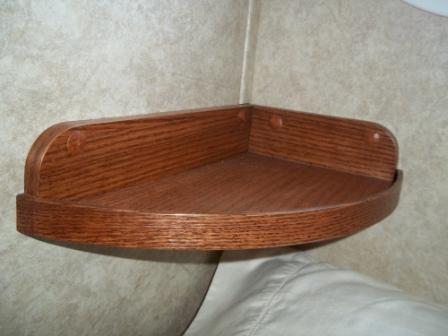

Marwayne,
I think your mods are great. Can you tell me what stain color you used to match the Pod's color.

Marwayne, maybe you should "copyright" your work - if there's such a thing in carpentry.  Your ideas are so good, I believe manufacturers should do some of the same things you did to maximize space.  But I don't think they should be able to "steal" your ideas!
And thanks to you and Tech for each explaining how you used -- or did not use -- mollybolts.  I appreciate EVERYTHING I learn on the forum.

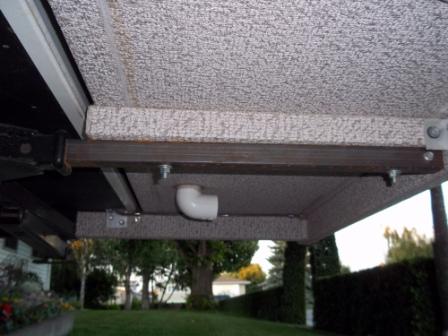

  No Doug those are not drains, they are vents, there are 4 of them. I have propane and gas in there, it is for air flow.

   Hodge-PODge
I have not yet used an anchor or mollybolt in my pod. The inside walls have a 1/8" plywood skin.
 So drill your holes in the wood bracket countersink them, hold the bracket in place mark the holes, then use a 1/16" bit drill through the skin, use drywall screws coarse thread ( grabers) and screw on the bracket . Dont use a drill or screwgun, you dont want to overturn the screw,if you overturn it it wont hold and you would have to use an anchore or a mollybolt.
