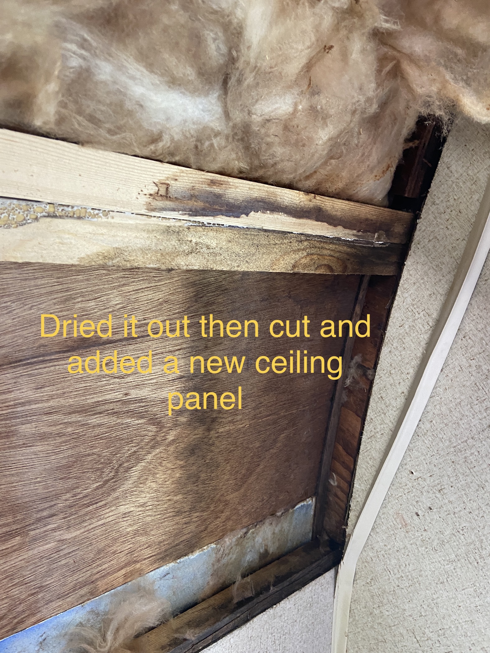

5200 is great stuff. just be aware if you aren't already that you will probably never get that apart again. The stuff is tenacious.
The issue with interior panel replacement will be matching the appearance, assuming that's important to you. Otherwise it probably doesnt matter what you use as long as it conforms to the curved surface. |

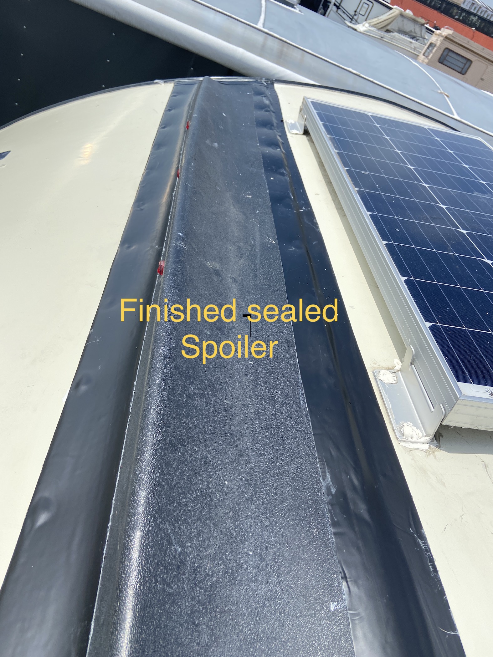

The video sure shows the cheap construction. Ill be working the outside first and replacing the spoiler screws with stainless ones and using some 5200 sealant. Once thats sealed Ill debate the patching or replacement. I see on the web that RV suppliers sell the 4x8 sheets of material that is specifically made for RVs. Sigh..........I bought the trailer thinking it would get me out more,but it seems like I end up working on it like a house..........Thanks for the reply and info and Ill take photos of the work for later uploading

You are far from unique there have been many leaks in the spoiler attachment holes reported here.

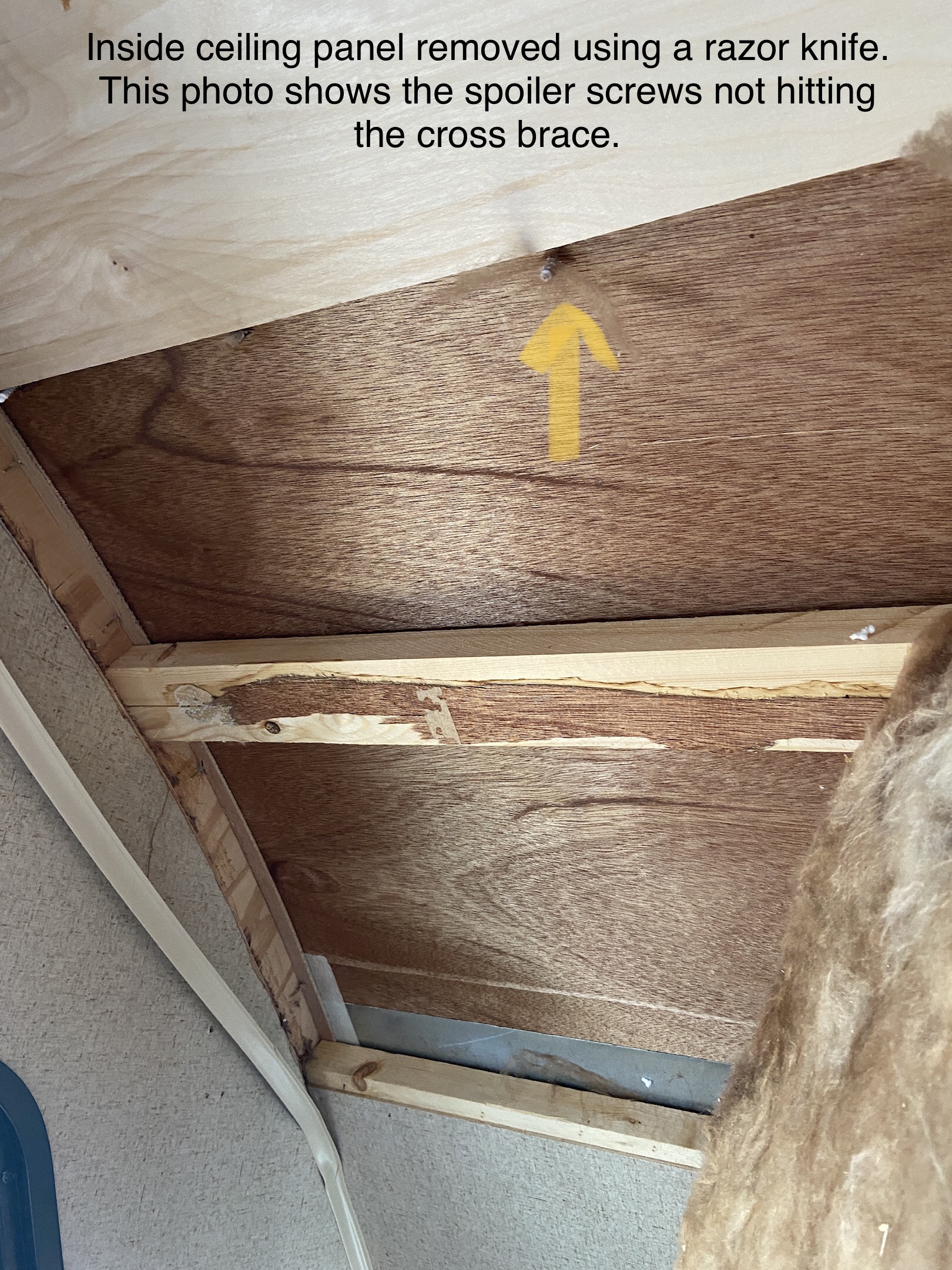

If you watch this video you can see how the curved roof sections are constructed. They are laminated ply interior sheeting stapled to 1x wood stringers, with insulation batts dropped in. So one problem is going to be getting the insulation dried out. It might be easiest and best to just remove the trim around the damaged panel and pull off the interior sheet so you can get at the insulation and also insect the stringers. Then staple up a new ceiling sheet with similar appearance and replace the trim. Patching some type of sandable filler like Bondo and then painting could work too if you're comfortable that things have gotten dried out and there isn't internal damage that will show up again later. Or maybe just remove the bulge and glue a patch or a photo/piece of art over the bad spot. Up to you. Construction video |

Turns out my 172 had a roof leak through the spoiler screws. Not sure why they didn’t properly seal them? My ceiling has no bulged out and I’m wondering where I can get that ceiling panels to replace it? It appears to be a melamine service on thin plywood. Before I remove it I was wondering if it would make sense just a scrape out the small area that has delaminated and Bondo it. Then paint over. Any suggestions?
