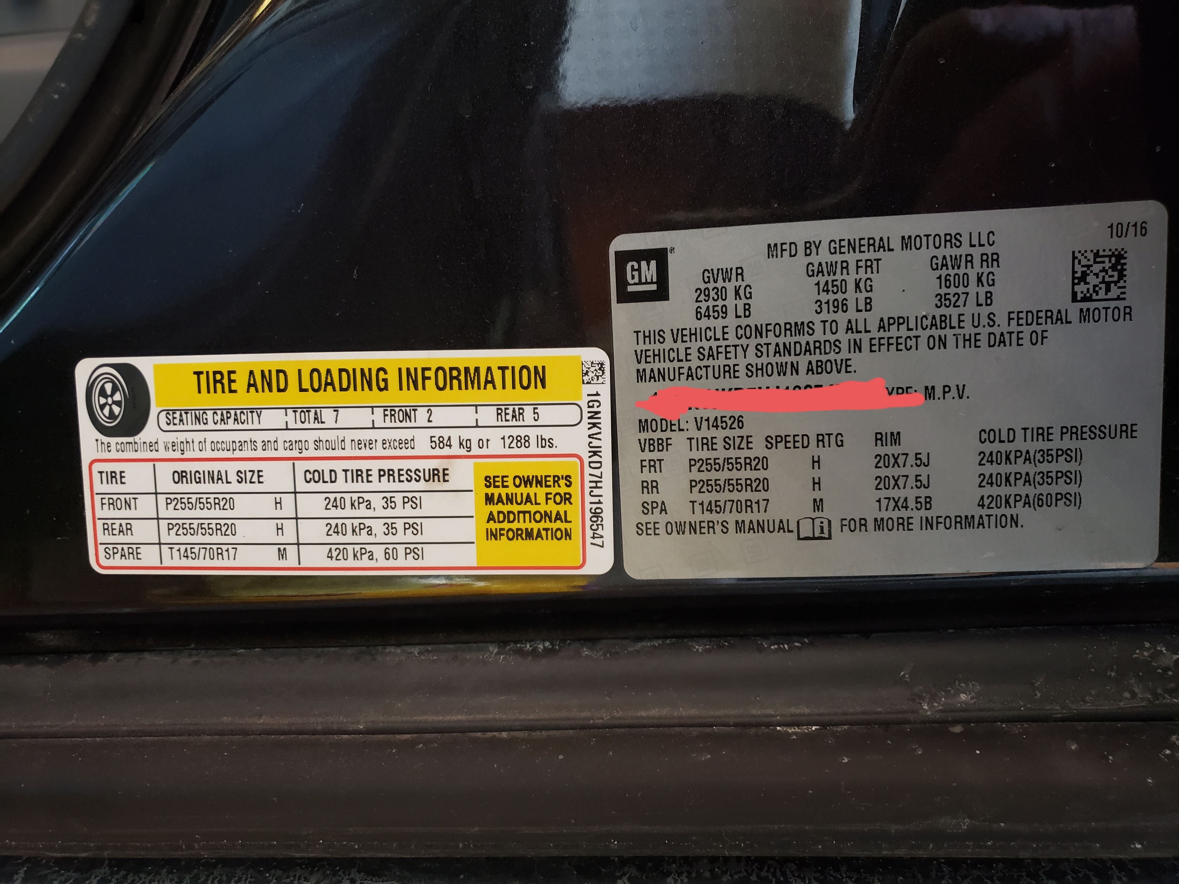

The trailer GVWR should be 4840 according to your sticker. Since the You need to get a tape measure and measure the distance from the trailer axle to the ball and also from the Traverse rear axle to the ball. Also measure the length of your wdh bars, I'm sure they're not 30 inches, typically they're 18. And the wdh rating should be what's published for your hitch, in the range of 600-1000 lbs for your rig.
The trailer GVWR and tongue weight should be your actual fully loaded weights as measured on the public scale.
if you choose to never fill your water tanks be sure to drain and dump at the campground every time before you hit the road. Consider if that's really practical for the kind of camping you do. If it's not practical then fill your fresh water tank before you go to the scales. As a minimum, you need to have the water heater tank full when you weigh. That's about 50 lbs right there. Fill your fuel tank too and take your wife and pets (if any) and all the tools, folding chairs, bbq grills, propane tanks, ground cloths, etc etc. You will be surprised how quickly it all adds up.

Well, I got 5 measurements with weight.
First  - Front axle with WDH - 2880
Second - Front/Rear Axle with WDH - 6200
Third - Front Rear Axe No WDH - 6300
Fourth - Fill Weight with WDH - 9820
Fifth Trailer axle only - 3580
Not sure what fields this will help fill in.  Will say we had 30 gal of fresh water within the trailer.  Pretty sure that's towards the front.  The traverse and WDH groaned a lot more in turns etc.  Felt heavy. As i understand it, generically, the website states that the hitch weight is 440 lbs. Using the worst-case dry weight (3,538 lbs), the hitch weight is (440/3,538) x 100 = 12.4% of the dry weight.   Should I use that to help figure the total weight of the trailer?  Or does that matter seeing that my axel weight of the trailer was 3580...

Post Options Post Options   Quote offgrid Quote  Post ReplyReply Direct Link To This Post Posted: 18 Mar 2022 at 6:38am
When you say you measured with the wdh you didn't have it tensioned did you? If you did that throws of everything so weigh again with the wdh in the reciever and the trailer connected, but the bars not tensioned or just toss the bars in the back of the Traverse. You do not need to get any weights with the wdh tensioned, the calculator takes care of that for you.
Add one axle to the scale at a time and record all 3 measurements. The front axle weight you get directly. The rear tow vehicle axle weight is the second measurement minus the front axle. The trailer axle weight is the 3rd measurement minus the second.
Now disconnect the trailer but leave the wdh in the reciever. Don't take anything out of the Traverse. Weigh again, first just the front axle then both. As before the rear axle is the second weight minus the first.
Tongue weight is the second measurement from the first weighing (both Traverse axles with the trailer) minus the second measurement from the second weighing (the Traverse without the trailer).
The total trailer weight is the 3rd measurement from the first weighing (total rig weight) minus the second measurement from the second weighing (total traverse weight without the trailer).
Fill the water heater before you weigh again if you haven't already.
Hope that helps.

Post Options Post Options   Quote offgrid Quote  Post ReplyReply Direct Link To This Post Posted: 18 Mar 2022 at 7:02am
The sticker does show the max rated weights. The R stands for rating. Put those sticker numbers in the calculator as the max rated numbers.
The weighings are to get actuals for comparison so put those numbers in the calculator in that area. Once you have everthing in the calculator you can look at the dual gauges at the bottom and see how close you are to your ratings. Note that the wdh does not increase any ratings, your tow vehicle and trailer have to be within spec without it.
