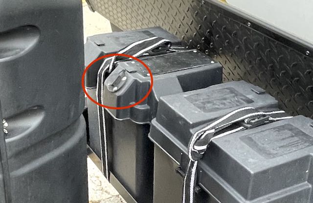

Here is my connection process from charge controller to battery. My charge controller is at the top right and wired to a short cable with an SAE male connector on the end. I then mounted an SAE female connector (right side) to the battery box with a fuse holder inline on the positive lead. The female connector allows me to plug in the solar without opening the battery box. It is like the solar ready connectors on many older versions of the RPod, I checked to make sure positive and negative are correct with the wiring all the way through.

Here is a view of the SAE connector on the outside of the battery box. Used silicone to ensure a waterproof connection. Small cover protects the plug when not in use. A metail plate added behind connector hold the charge controller which has magnet attached to the back.
