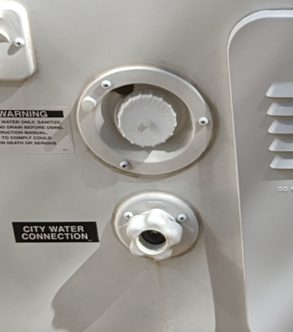

The city water connection is on the high pressure side of your pump. There is a check valve to keep city water from leaking backward through the pump into the fresh water tank, and another one keeping the water pressurized by your pump from leaking backward out the city water line. There is no reason for the city water connection to cause your issue unless there is water leaking back out of the city connection when you turn on the pump. I think your problem lies elsewhere, either on the suction side of the pump from your fresh water tank or in the pump itself. If using the antifreeze suction line from a water container doesn't fix the problem then its most likely the pump.

So this is a photo of the water connection....just to confirm...this needs to be plugged when using the tank?

OK...it's going to be very embarrassing to find out the source of all the problems is that I just didn't have a cap on the city water connection.  As I picked up the trailer that way, it never even dawned on me.
On the other hand, I will certainly have learned a lot...including how to remove and disassemble and rewire an RV water pump...

The city water pipe needs to have the cap on. Otherwise, there is a valve inside to prevent reverse flow. If there is not a cap on the city water connector, then that might be the source of the air. I had not thought about that. On our 179, it is a black cap that fits in the opening, much the same as the black water tank fitting. Both have the same type cap.
If the cap is missing, see if you can find something to plug the opening. You would likely be able to find a screw-in plug at a plumbing store or plumbing section of one of the big box stores.

One thing...when I was following the pipe paths....it seems that the city water line feeds into the path somehow....how is that valved out...as on the outside of the trailer, it is just a female connector?  That is not supposed to have a plug in it?
