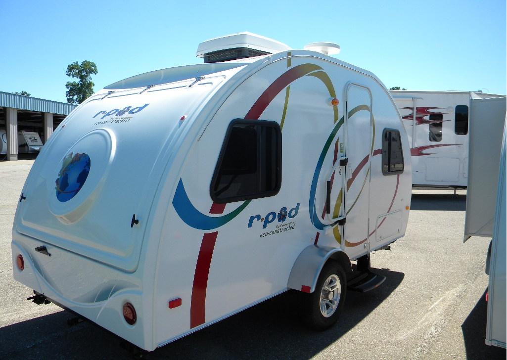

For anyone who's wondering what airfoil they're talking about, here's a pic.

Great close up photo. Much better than the one that I found previously.
While at the Eastern Round up in Kentucky, I talked to the FR engineer who readily admitted the spoiler on the 173T was to reduce drag. I did not ask about having the airfoil available as an after-market kit because I did not figure that it could be done without compromising the integrity of the unit. The 173T seems to have some additional components for the slide out that support the airfoil.
