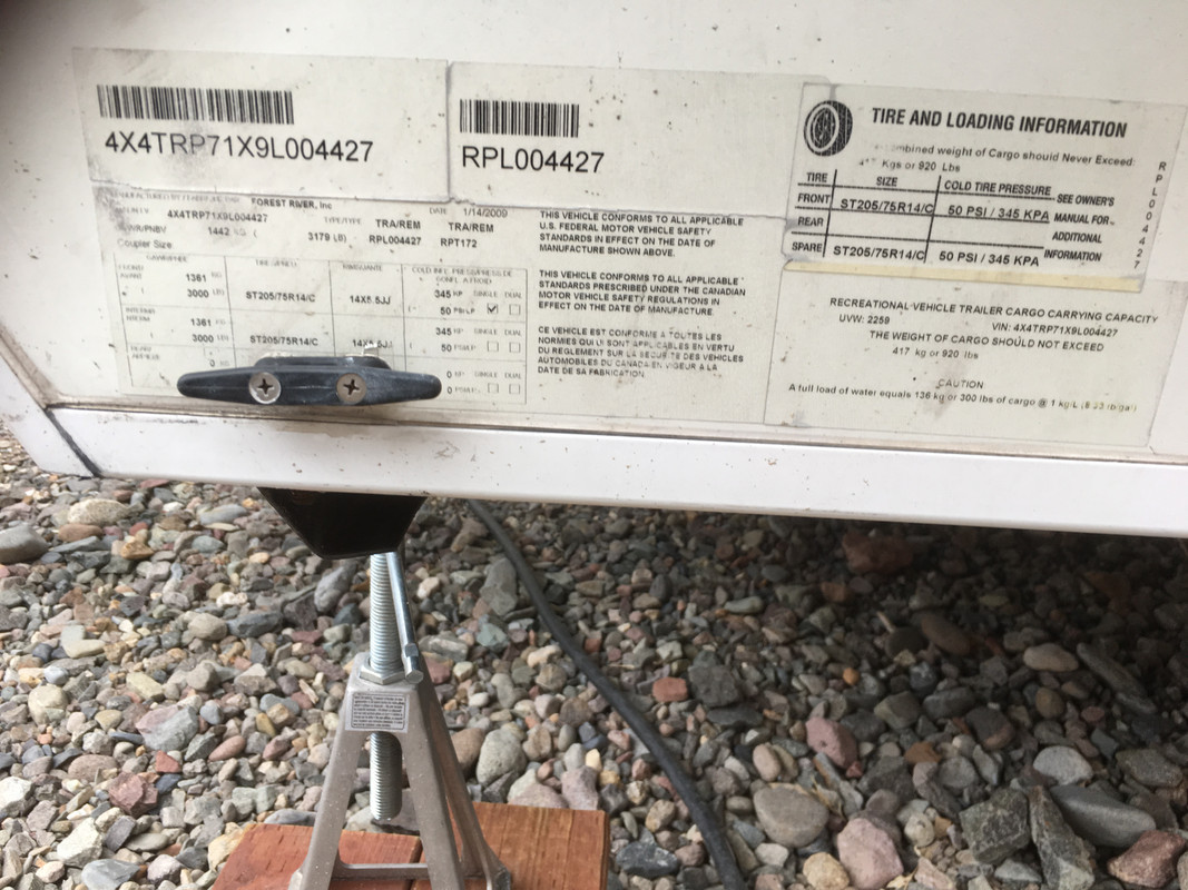

I should clarify my comment that " our 172 appears to have a 3000# axle."  That is a number I found on the data plate in two places.  The print was so small and worn that I cannot be sure the 3000 number is really what it seems to be.  I took a picture of the data plate and here it is:
Unfortunately, my line cleat obscures one segment of the data plate, but I don't think it was the critical info.

Here is the label from my 16-171:

michaeln, our posts crossed in cyberspace.  So, how come your data plate looks so nice and new.  Could it be my trailer is a 2009 and yours is nice and new?
