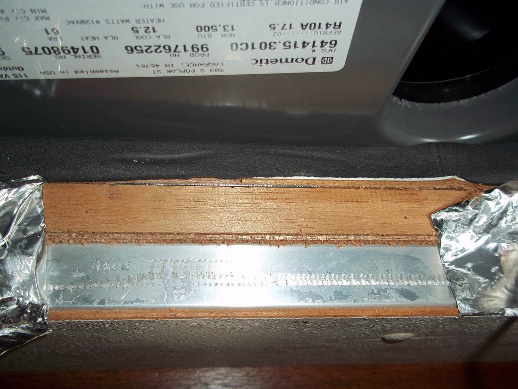

I called FR and they confirmed that the wall top frame members are 1 inch square box tubing that they buy pre-curved. Tubing wall thickness was estimated at 1/16 inch, but I'd sure like to confirm it.
marwayne, do you happen to know the box tube wall thickness?  If not I guess I can pull off the air conditioner diffuser, drill a slot and get in there and measure it with a micrometer.
It looks from the video showing someone on the roof that the flat part is the only part you can put weight on, the rest is just lightweight wood crosspieces.  That confirms to me that I want to mount large solar modules only to the wall top rails at least for ones that aren't in that center section.
I could have upwards of 1000 lbs uplift on those big 77 x 39 inch modules.  I'll take a look at self tapping fastener pullout strength in .062 aluminum. At least there are two wall surfaces to attach to. Should be doable if I use several fasteners per side. I can do a pullout test on one before putting them all in.

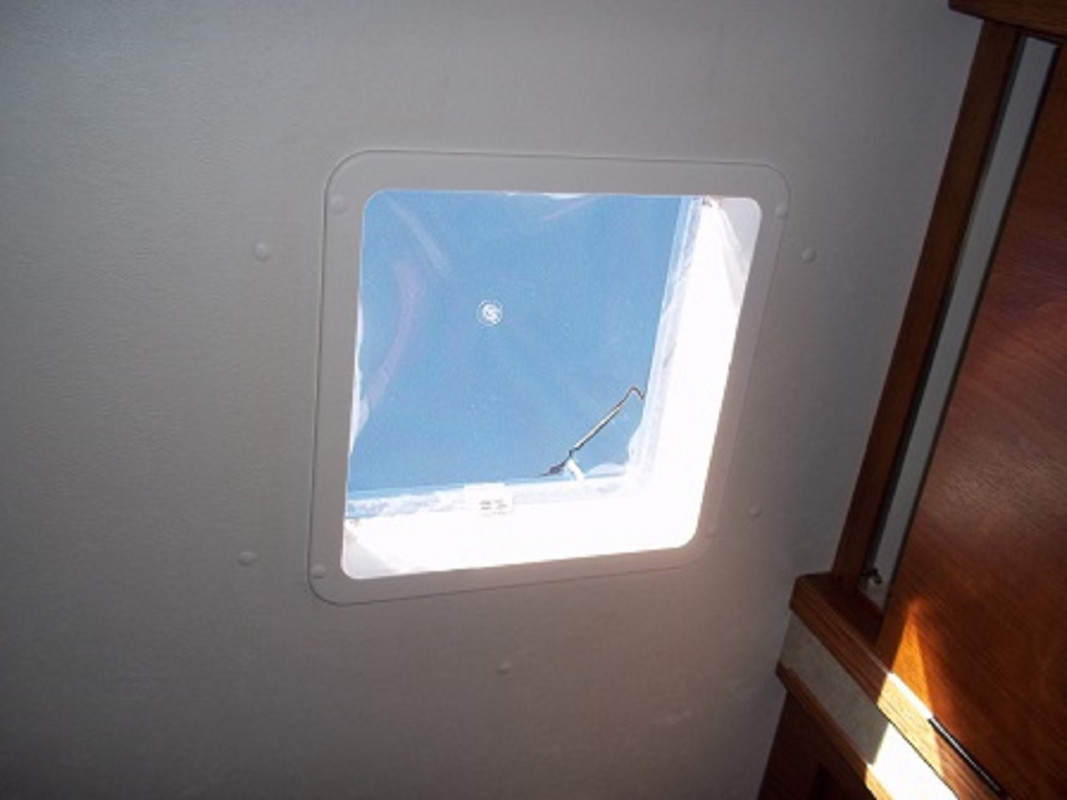

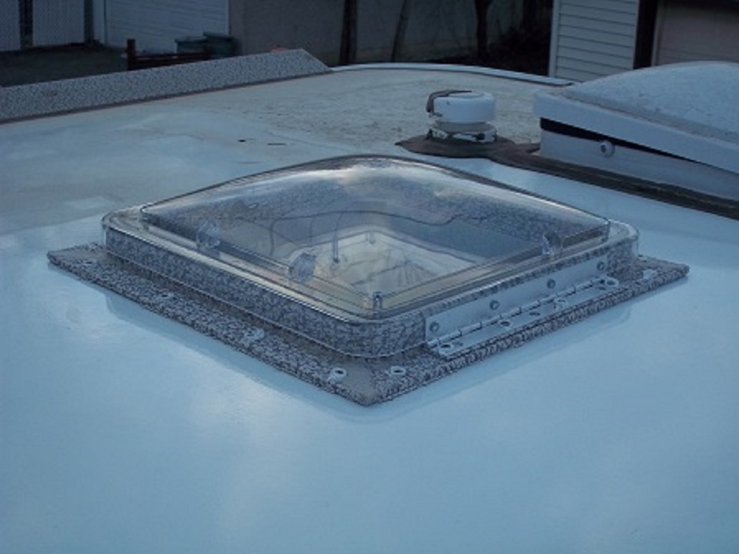

Direct Link To This Post Posted: 02 Oct 2018 at 6:40pm
This instead of AC
Posts: 3436
Direct Link To This Post Posted: 02 Oct 2018 at 7:40pm
Very nice Marwayne.  We toyed with that very idea when we ordered our 177 w/o the A/C.  However we went with the lid like you have but also have the lower area screened so that we can open it like the FF for additional air movement and cooling.  We have also noted a huge difference in the brightness inside our 177 compared to others that have the A/C.
Posts: 1004
Direct Link To This Post Posted: 02 Oct 2018 at 8:21pm
I didn't want any hardware or screen to look through
