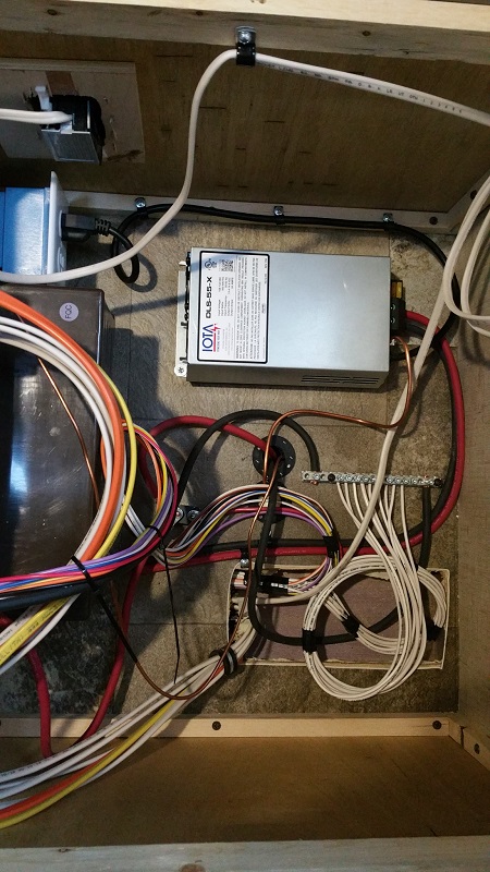

Here's an update to what I finally did. I agree that vibration is the issue. When I removed the 8955, the ground wire to the 120 v side was just laying there and the screw that held it to the converter was also just laying in there. Sounds like there are a lot of different fixes for the issue. I first swapped out for a PD 9260 as per my previous post. I just couldn't get use to the buzzing when the fan starts and stops. Sent it back. Second one did the same. Sent it back. I have to say that customer service at PD is excellent! They really bend over backwards to make sure that you are happy! I have come to the conclusion that this is just how they work. I can't take it. Buzzing and electronics just don't seem to go well together. Just me. While waiting for the third one, I ordered and installed an IOTA DLS-55-X with the IQ4-X smart charge module. It is extremely quiet! I also replaced "all" of the 6 gauge wire on the 12 V side (clear to the batteries) with 4 guage. The voltage drop from the charger to the batteries is minimal. Hopefully this will cut down on generator run time to get a full charge while boondocking. Since I had gone through the whole warranty thing with the PD, I can't get my money back. I now have a brand new in the box PD 9260 with pendant sitting on my shelf as a backup that I will never use. Oh well, that's what I get for being an*l.
