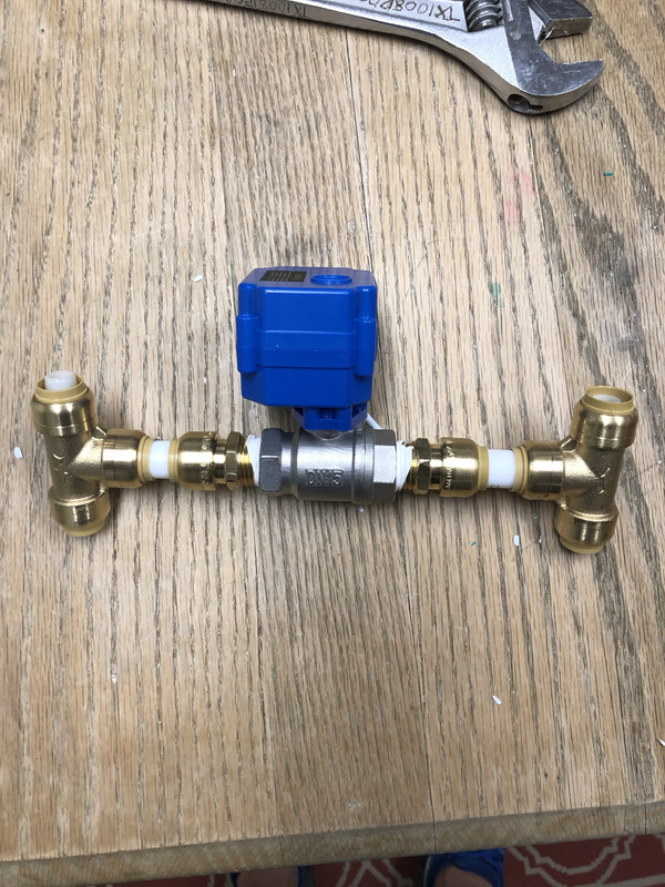

this is the mixing valve that will go at the rear of the pod (farthest point from water heater and pump)

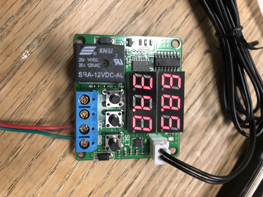

Testing the thermostat with a 9v battery. it works so far. i could not get the relay to work yet using 9volt. I think it must need 12 v to function. I plan to test all of this before cutting pipe in the pod to install all of this.

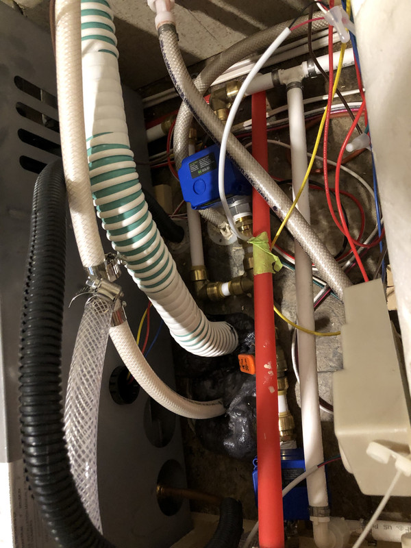

Worked on two mods Sunday. The recirculating hot water first. I installed the valves and did a quick pressure check and that all seemed good. I opened the manual valve to do further pressure checks but i ran the pump dry, so i will have to prime it i suppose to test further. I was out of time to add water and do the real tests and is still need to install the rear mixing valve. The main reverse polarity valve is wired to the red/yellow switch in the panel and tested and works fine so far. It is really tight where i added the new valves. Difficult to get clean square cuts in the Pex. i think i got it in correctly since i saw no leaks with initial pressure check.

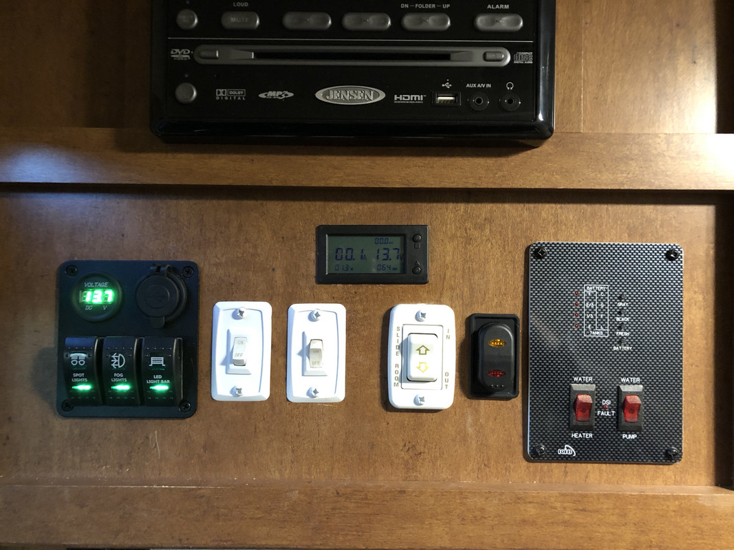

 i added the drok battery meter also.
texman
Joined: 24 Jul 2014
Location: TeXas
Posts: 446
Posted: 11 Feb 2019 at 8:54am |
after i installed the DROK, i disconnected the shore power and attempted to set up the meter. all seems good except i haven't figured out (been able) to set up the capacity and remaining amp hours. by that i mean i set them up in the device, but i am not getting them to calculate yet. But while i was testing this on battery power and working on the other stuff, i watched my voltage drop to 12.2v in less than an hour. The pic is the reading while hooked up and charging. So i don't know if i have fried the batteries somehow or not. they have been plugged in and charged the whole time in storage and i have added distilled water a couple of times. So i wouldn't think they are fried, but don't know why i would drop to 12.2 v otherwise. thoughts? only load was a couple of LEDs and the base pod loads of detectors.
