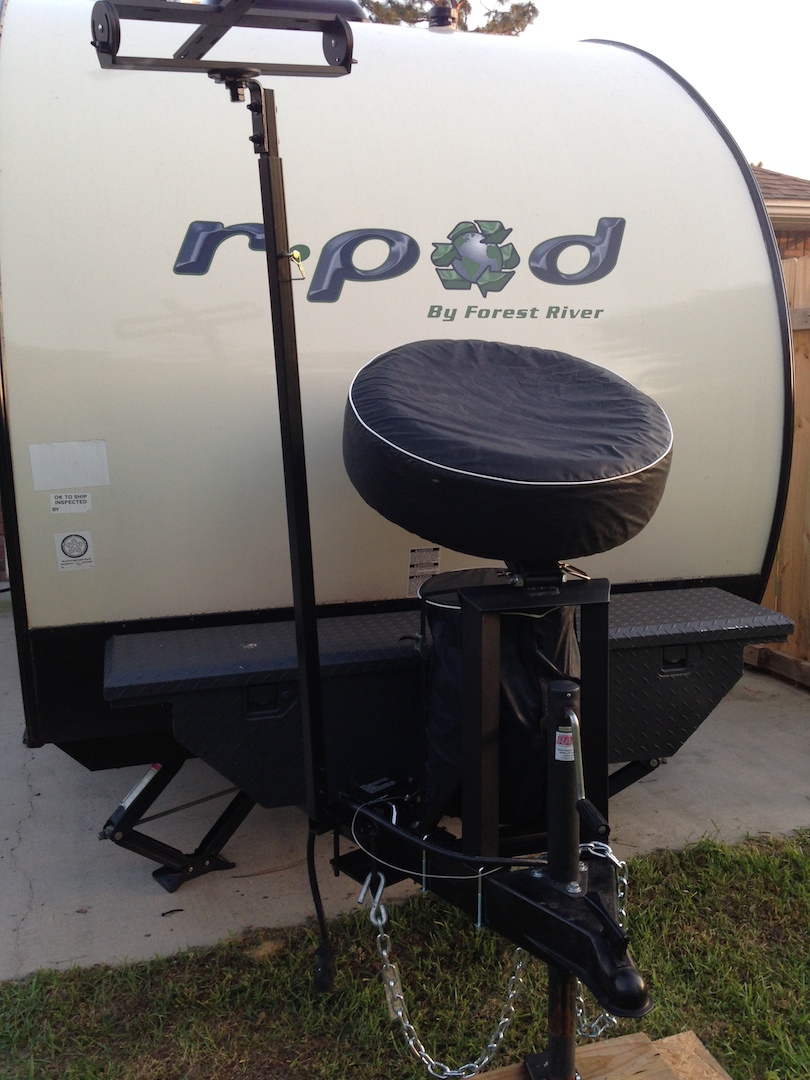

RPOD RP-172
MODS:
1. Relocate the spare tire to the tongue.
2. Install a second battery.
3. Fabricated a mount for Goal Zero Solar Panel.
4. Install a diamond plate tool box on the tongue.
5. Install sewer hose pipe underneath and behind both tires.
6. Install curtains and curtain rods on both bunked.

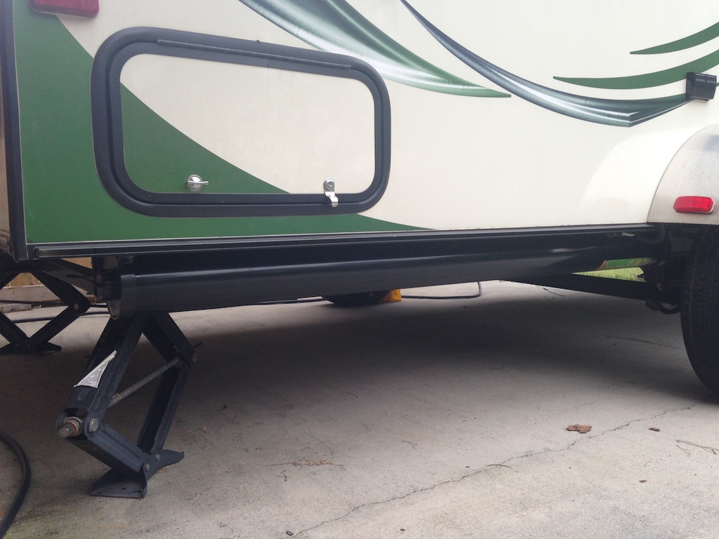

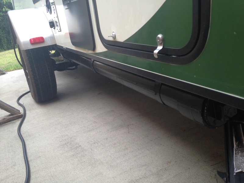

We would be interested in seeing what you did for Mods #5,6 & 7. Thanks.
BAYAGMO2 View Drop Down
Joined: 04 Jul 2014
Location: SAN ANTONIO, TEXAS
Posts: 15
Post Options Post Options   Quote BAYAGMO2 Quote  Post ReplyReply Direct Link To This Post Posted: 15 Jul 2014 at 8:01pm
Left rear tire,
Right Rear tire,

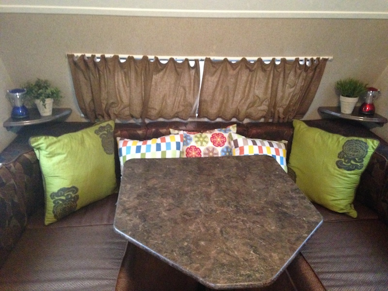

7. Install two corner shelve behind the dinette.

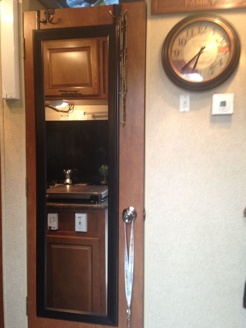

8. Install mirror on the bathroom door

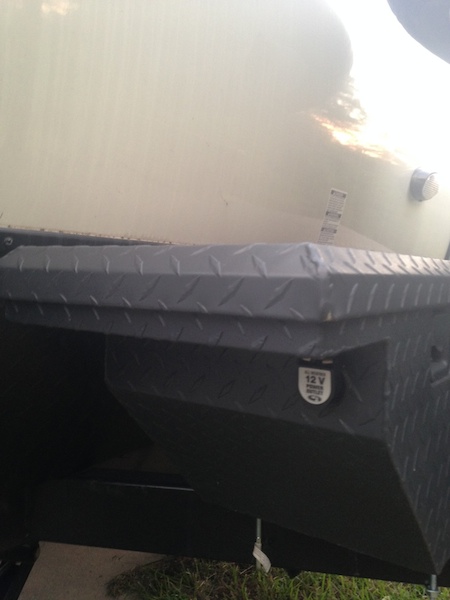

10. Install 12V auxiliary from the tool box

I really like the curtains on the bunks!
More info, please, on the spare tire carrier & the bracket on the tongue next to it. What is that for??
Darryl, Julie & Lindsey
2014 RP178
Joined: 04 Jul 2014
Posts: 15
Post Options Post Options   Quote BAYAGMO2 Quote  Post ReplyReply Direct Link To This Post Posted: 15 Jul 2014 at 10:27pm
As far as the tire carrier, I built a new mount for the tire, the tire can swing to the front using a pin so you can remove the gas tank upward.
The bracket on the tongue is for my Goal Zero solar panel, I have a 4 Boulder solar panel that I can connect together, each panel has a 30 watts output.
LAND ROVER LR3 2006
RP-172 2014
THE LAND RoPOD

Very cool. We have an 80 watt Zamp that we use. I'd like to see detailed pictures of the spare tire carrier. That would free up the back for a smoker carrier....
2014 RP178
Joined: 04 Jul 2014
Posts: 15
Post Options Post Options   Quote BAYAGMO2 Quote  Post ReplyReply Direct Link To This Post Posted: 15 Jul 2014 at 10:39pm
I will take some photo tomorrow and post it here. It was a great idea to move the tire to the tongue because i was able to mount all 4 of my bicycles.
