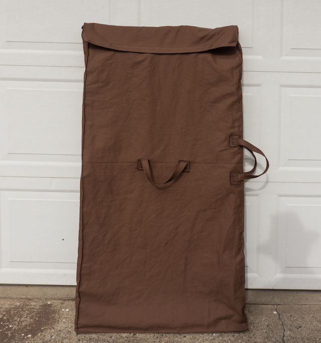

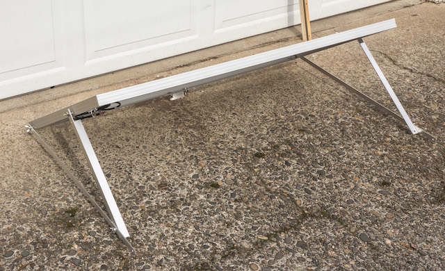

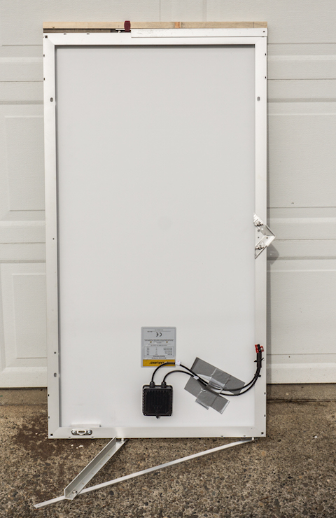

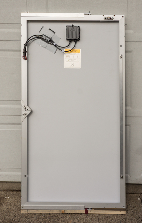

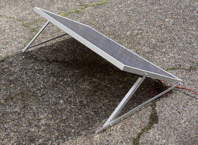

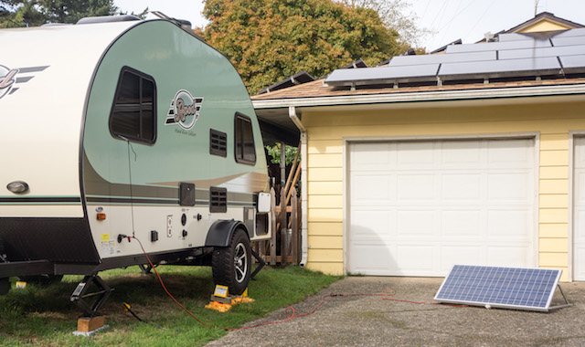

I hadn't really totaled it up before. But here's an estimate:
For comparison a 120-watt, 12-volt Zamp solar panel with Pulse Width Modulation (PWM) controller goes for around $641. While it is a more polished and easier to use setup, it comes with the less expensive & inferior PWM controller. But the Zamp outfit is folding which makes for easier storage. Ecoworthy and Renogy also make folding solar panels. The Solarland 24-volt solar panel is quite a bit more expensive than a similar 12-volt panel. The maximum power point tracking charge controller is more expensive than a similar pulse width modulating charge controller. But it will harvest a lot more energy from an expensive solar panel. And it allows using high voltage panels which will operate with less power and voltage loss. I can also use my 185 watt, 24 volt panel with the same controller. I will be using this solar charger at campgrounds without electric hookup and at each summer's Golden State Star Party. I might also make it to next year's Oregon Star Party. Both outings will be boondocking.
