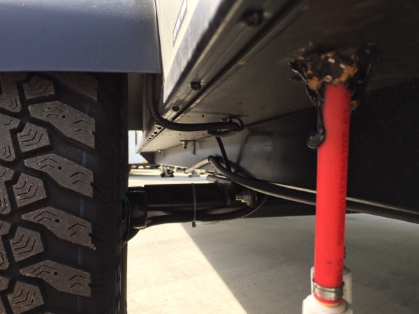

Would this be too close to the wheel to mount some 4" square sewer hose storage pvc? Running along outside the frame between the rail and the wheel:

You have plenty of clearance, make sure you attach it well to the frame.  We mounted ours under and behind the propane tanks in the front of our 177.  Works well and is convenient.

As far as mounting this section to the frame, is it ok to drill into the steel bars or would I want to mount to the upper section - I'm not sure what that material is without going and looking.
Direct Link To This Post Posted: 12 Mar 2016 at 9:24pm
Mount it to the frame.
