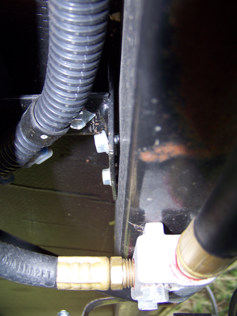

Posted: 12 Mar 2016 at 9:23am |
Well, the problem does not seem to be only in older models. Mine is a 2016 179.
![]() I intend to contact Forest River to see what they say about this. Mine is still under warranty. I hope they will fix this shoddy work. I appreciate the warning to check. I also noticed significant rust spots on the frame that I will be touching up before taking it out again. |

If you get FR's OK to have a dealer repair your Pod I caution you to understand the underlying problem and carefully checkout the fix. Keep in mind a full tank can weigh in excess of 250 pounds while you're bouncing down the highway. The alignment of the brackets must be corrected, all welds checked, all gaps fully filled, and larger screws installed. Many dealers will just apply the fastest, cheapest bandaid and declare victory. You'll only get one shot at a warranty fix.
